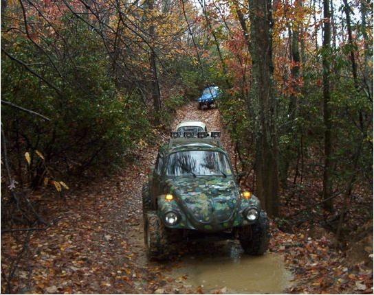

L Bug Baja....who said it can't be done......
http://www.thesamba.com/vw/gallery/pix/183458.jpg

just by lookin, and im no expert, but that look like the bodys propped up on another chassis, which is sporting different axles.
bug body, sierra chassis, hilux axles?

Ummm, dont think so - sierras are front engined and I cant see radiator etc
I had a go at the photo above - looks to me like someone has just grafted a beam front frame head on the floorpan
posted on December 9th, 2004 at 04:46 PM
Would be lots of mods to the front end...
as the coil springs-McPherson struts are bolted to the BODY Not the chassis as in normal Beetles...
and in standard form...
hitting the gutter can damage the front suspension - strut mounts... bend the body...

true, didnt think about radiators, although i have seen a few trick set ups. this blokes either nuts or a real vw enthusiast to have done this all the same. salute!

it sure looks like beam front end with longer trailing arms

That looks like it has th standard L-bug pan from what I can see but on a lift kit. Can anyone else make out the hammer head style 'pan end under there?
The L bug should be fine for off roading. Just reinforce your strut mounts and it should be cool. All your big 4x4's run mcpherson strut and they all seem to be doing all right.
