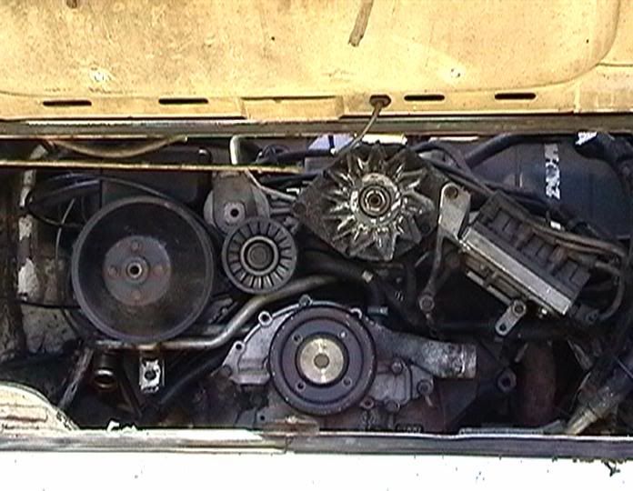

posted on December 27th, 2004 at 12:07 PM
mate untill you sort out the G/B just throw on some big ass tiers, your revs will drop for sure!
albins are the way to go.
here are my two
the first i a V8
http://img.photobucket.com/albums/v229/wacked1/ausmattside1.jpg
http://img.photobucket.com/albums/v229/wacked1/rear-sumpclearence.jpg
this is the V6
http://img.photobucket.com/albums/v229/wacked1/new3.jpg
