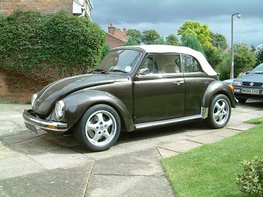

At the moment I am playing around with some 996 18" GT3 rims with a stock body. Not decided on a colour yet, it's white at the moment:
http://www.ricola.co.uk/cab_sport_designs.jpg
Will carry on the theme inside as it has got now (grey leather electric 944 seats)
Rich

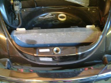

One big radiator!
http://www.ricola.co.uk/images/cabrio/rad_fit.JPG
Rich
