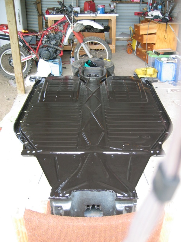

posted on March 13th, 2005 at 07:29 PM
HERE'S MY KOMI BEFORE I USED POR 15.
WIRE WHEELED IT, PREPED WITH POR CLEANER, THEN APPLIED POR ANTI RUST CONVERTER, FOLLOWED BY A GOOD LICK OF POR 15. STICKS LICK SHIAT TO A BLANKET IF YOU FOLLOW THE INSTRUCTIONS CORRECTLY..
http://img.photobucket.com/albums/v365/deca000/before-por15.jpg
Member58SPLIT
Posts: 148
Threads: 15
Registered: May 7th, 2004
Location: Coffs Harbour
Mood: schwiiiiiing!
posted on March 13th, 2005 at 07:30 PM
THE FINISHED RESULT..
http://img.photobucket.com/albums/v365/deca000/AFTER-POR15.jpg
