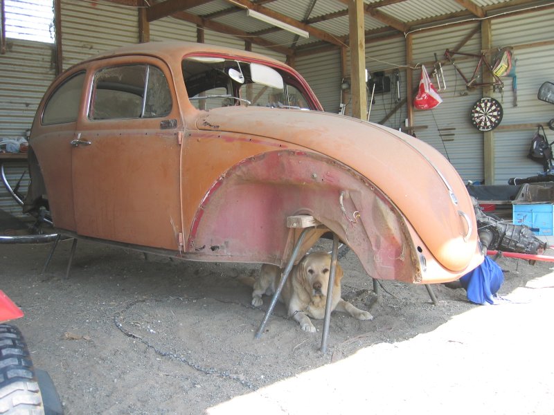

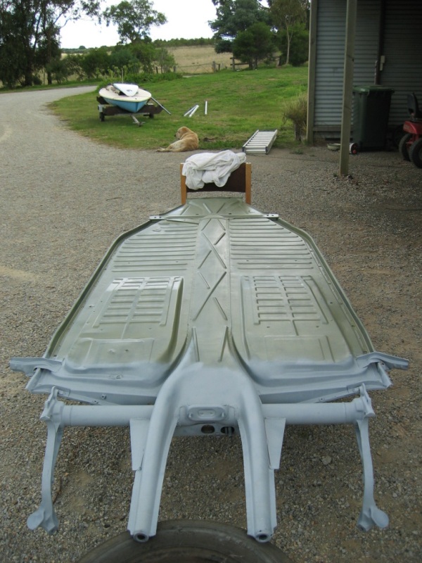

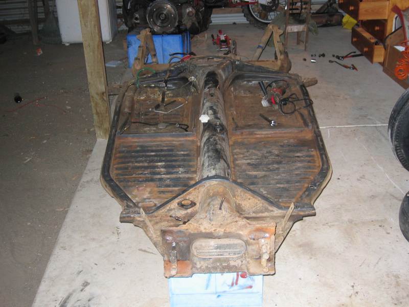

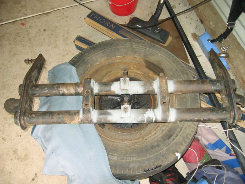

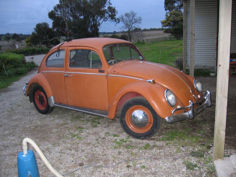

Thought I might put up some pics of what I've been up to the last few months.
Cant really be bothered typing to much but basically I'm making a full bodied off-road sedan, like the Class 11 cars of Baja or the old military 82E Kommanduerswagens (with out the kubel chassis..)
Hope to be done in a couple of months (famous last words eh?)
anyway Ill let the pics do the talkin, they go from Last October to a few days ago.
Work is moving along quickly so I'll prob keep updating this thread
chewy

Looking great , worth all the effort. Dog doesnt look to chuffed!

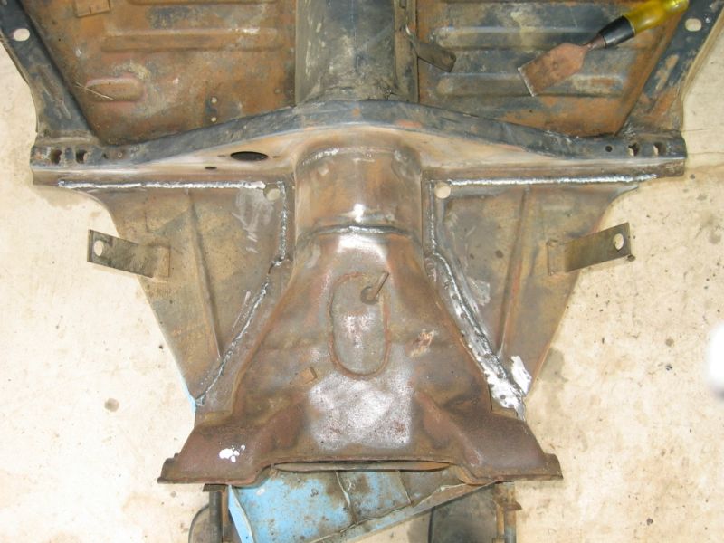

comin along well. I hope my pan comes up aqs good as yours looks.

the pan don;t look near that good in real life Blue.. dont know why the photo turned it up so nice.

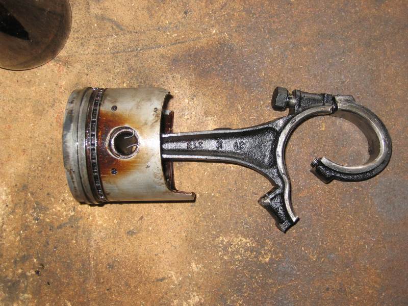

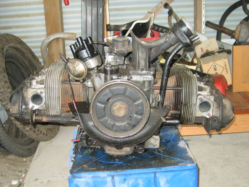

what happened to that rod man? :duh

For some reason or another one of the bearing cap bolts was loose, was gonna fix it but let my mate drive the chassis, he gave it a little too much and it went pop.
The cap was crushed between the crank and valve lifters and the upper porsion was ripped open when the piston stopped in the bore and the crank kept going.
