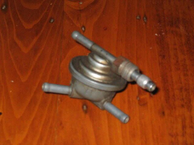

Another, I was getting some fuel leaking out of the carby, could not tell exactly where from, but it was leeching out, this was on the engine when I go it... hooked up to the fuel lines...
http://img.photobucket.com/albums/v296/warbklone/Picture3022.jpg
Is it a pressure regulator, if so, should I put it back on, guess it was there for a reason..

i think that looks like a one way valve
it was installed on cars that were parked on hills
it stopped all the fuel being siphoned from the tank into the crankcase
you can leave it off(if your not always parked on a hill)
probably get a fair $ for it too!

i think your right there, i can blow one way through the bottom, but not suck out the other end, interesting..
