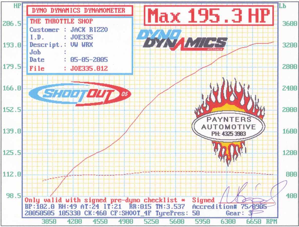

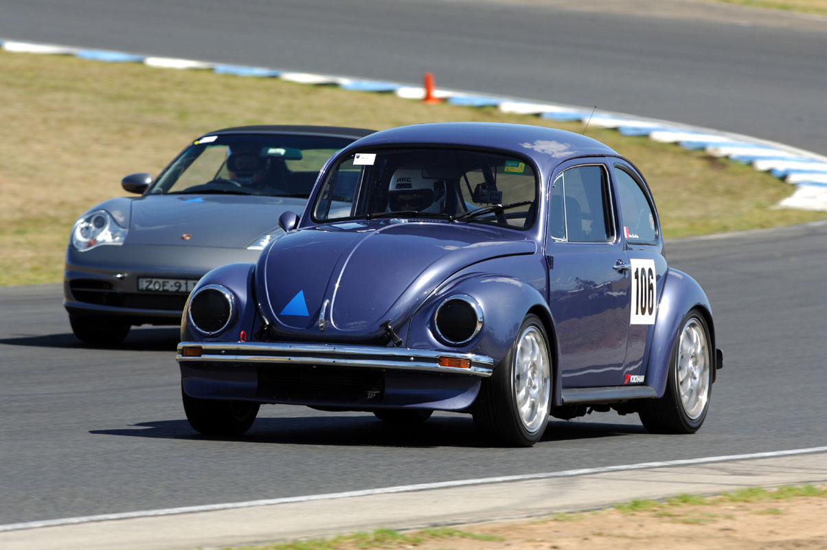

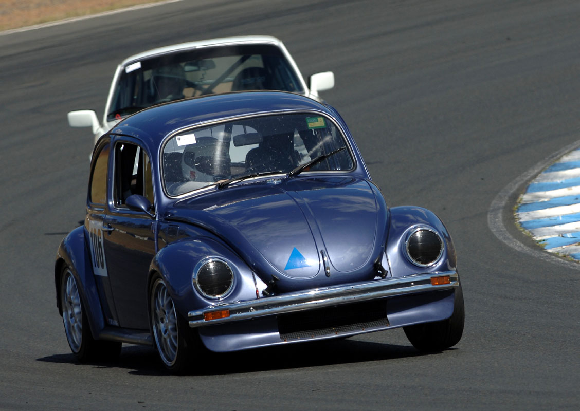

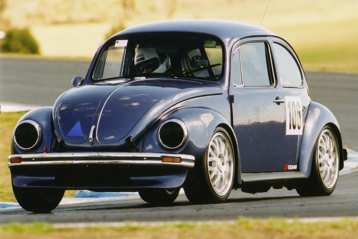

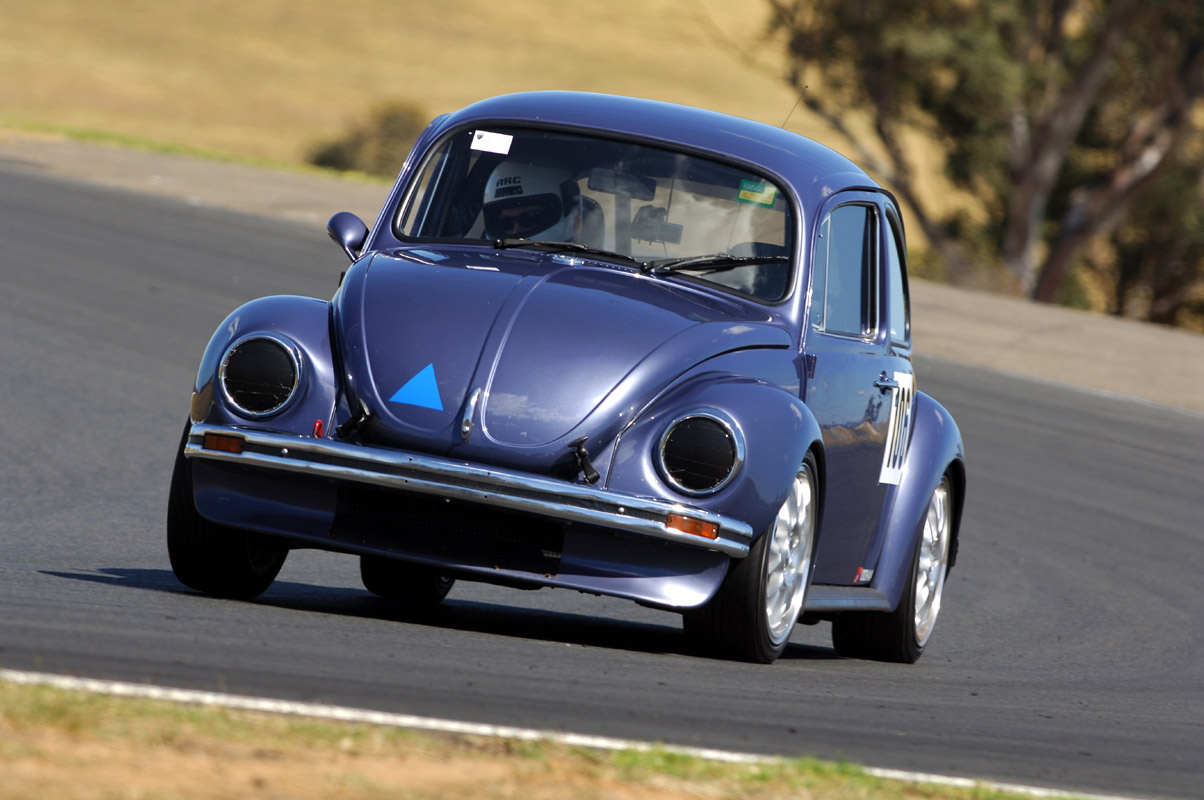

Hi Boothy,
I'm on the Central Coast as well, u are more then welcome to have a look at my car if u like.
regards
Jak
Some pics to wet your appetite.
