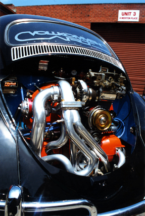

Hey Dave,
It was a spare engine l had lying around. A T4 draw through with a Holley 600cfm.
Berg 69 crank, 42x37.5 heads ported by us (Vollkommen Art) and Autocraft 1.4 roller ratio rockers. 165kw @ the wheels on 19 psi.
Stock 1st and 2nd ratios with a 1.56 3rd and 1.14 4th.
I only raced the car once as it was a street car did NOT have a rear end that works as you can tell by the 1.9103 60ft time.
Crossing the line just under 6000 rpm.
12.49 @ 114.62mph
I am guessing the car weighs about 870kg
I hope Pete will post the pic I sent him when he gets his computer running again.

posted on January 13th, 2006 at 02:26 AM
VOLLKOMMEN ART
Hi Dave,
I call it a pro streeter because I dont want people to start with the street car crap. It is still reged and is a true pan car with std rear suspension. It is not a race car but I have done things to ANDRA specs.
I 'll take it out in about 3 weeks.

VOLLKOMMEN ART
Hi Dave,
84x94 2332cc
T66, Microtech
290 kw @ the wheels on 26psi
but only ran 19 psi to go 128mph
I was driving it easy not wanting to break anything,
having troubles getting 3rd with the vertical
http://images.thesamba.com/vw/gallery/pix/249375.jpg shifter.
Some rod adjusting I think?
A few more mods including bigger injectors and maybe an intercooler.

Thanks Dude,
I have had a few set ups end engines in this car.
It has always had a miss. I have even totally re-wired the car a year ago. In changing the set ups over the years I have fitted new pumps, tps, crank angle,leads, coils, manifolds, turbos, and throttle bodies.
Last time I raced it it went 11.06 @ 127 with a miss in every gear at about 7000-7500 rpm. It was like a rev limiter was on but I have checked that they are off about 20 000 times. I fitted the msd to see if it would improve
but no go.
I'm thinking an internal igniter because the miss is moving down around the rpms and inconsistent.
I have put a new computer in now and will test it out as soon as I get a chance.
The Microtech computer is load(map) Ms Vs Rpm.
So you can tune load setting only or correct them through rpm if you want.
