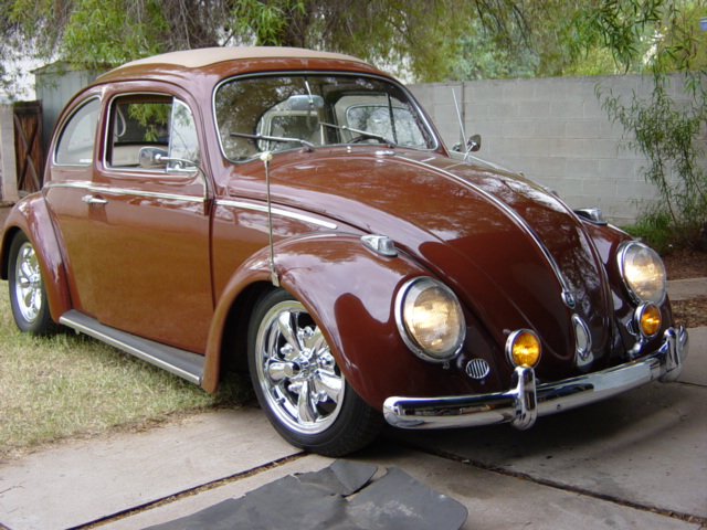

i know that you people are talking about stock wheels here, but I have 215/60's on my 5.5inch Five spokes. And a freind of mine has 205/70's on his car. Sometimes smaller tire shops will try different sizes on your rims to see which is the best for you. I say this because if you dont, you will get the opinion for the masses, not for the individual. I do stuff to my cars that could be seen as unsafe to some people, ( like not running shocks on the front). but, they dont know how i drive or how often i drive it. If VW sold cars with 135's on the front, they would be junk due to poor handling and braking. But that is for the individual, do get what I'm saying? Im not sue I do. ohh well, heres a pic of my friends car on 205/70's on a 5 spoke
http://thesamba.com/vw/gallery/pix/59748.jpg
Scott R.

HOLY CRAP MAN!
Thats one hell of a ride you got there!
Should be in Members rides!
Sweeet!
