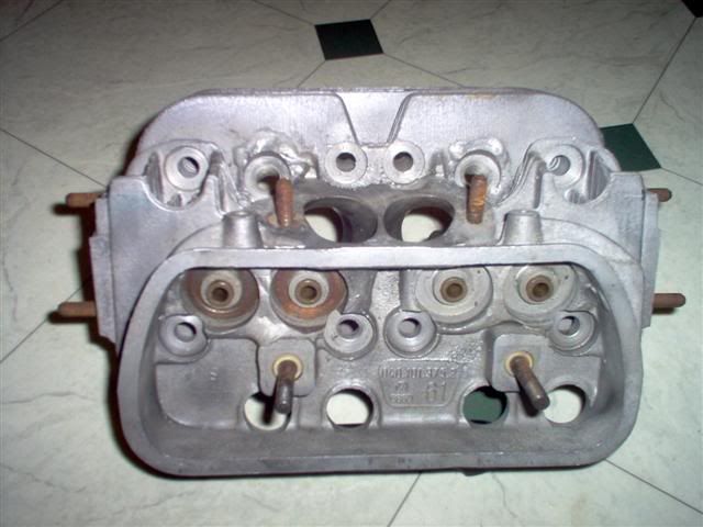

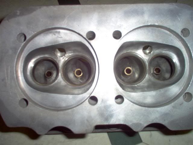

here is what you need to "use" a 319 cam...
MASSIVE welding and porting...
http://i31.photobucket.com/albums/c365/dumone/IM000264Small.jpg
welded and built up spring seats for chevy style springs lifting over .600 at the valve. shim em up tight enough for enough pressure to run in the 5000 to 9500 rpm range. and be prepared to change the broken ones

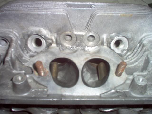

need to weld the back too to get the inlet ports big enough...
http://i31.photobucket.com/albums/c365/dumone/IM000266Small.jpg

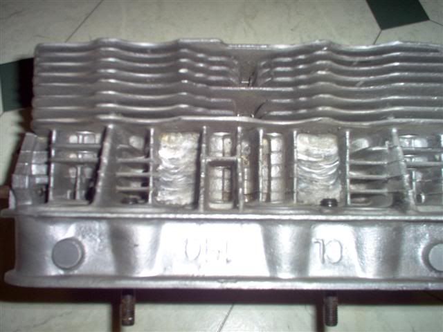

make room to get the spent gases out too!..
http://i31.photobucket.com/albums/c365/dumone/IM000265Small.jpg

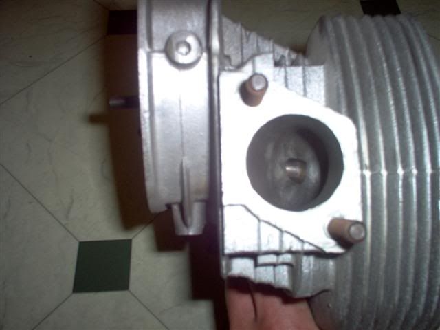

race seat grind, relocated the plugs,reshaped chambers, 44 and 39 valves
http://i31.photobucket.com/albums/c365/dumone/IM000267Small.jpg
