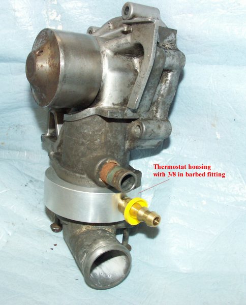

There is a fix the vanagon guys use in the US for the colder climate when they use the heater alot
http://www.subaruvanagon.com/tom/Cooling%20System.htm
http://www.subaruvanagon.com/tom/Cooling/Pump%20thermostat%20assembly%202%20sm.jpg

That's an interesting item that I've not seen before. Apparently, the new part moves the thermostat a couple of centimeters away from the heater return flow and supplies a warmer coolant flow straight from the engine coolant outlet to operate the thermostat.
It still seems like a rather silly arrangement to me. Why put the thermostat at the inlet and then kludge an outlet-to-inlet bypass to provide a temperature signal for the themostat?
