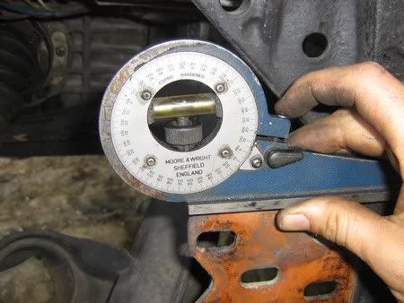

This will need a change of about 3 degrees in spring plate angle.
http://i113.photobucket.com/albums/n216/dangerous_05/ProtractoronSpringPlate.jpg

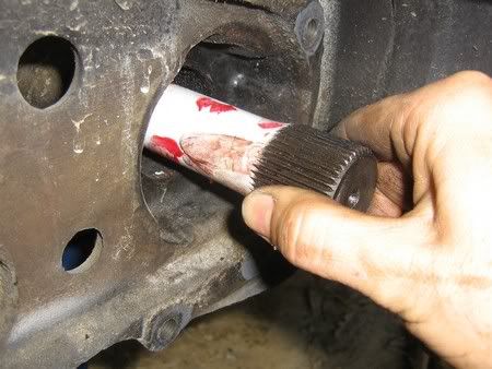

To do this, I needed to go 4 splines UP on the car, and 4 spines down on the spring plate.
http://i113.photobucket.com/albums/n216/dangerous_05/30mmTortionBar.jpg

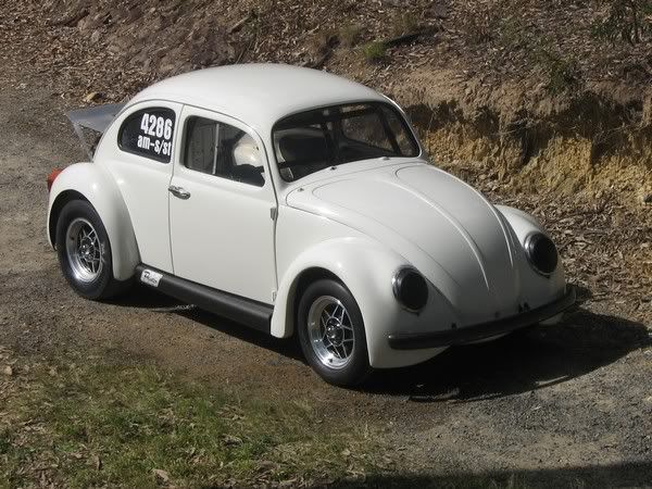

http://i113.photobucket.com/albums/n216/dangerous_05/Img_1412.jpg
http://i113.photobucket.com/albums/n216/dangerous_05/Img_1411.jpg
http://i113.photobucket.com/albums/n216/dangerous_05/Img_1407.jpg
