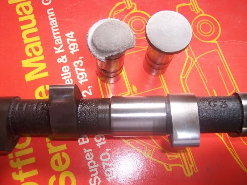

I think the problem is universal, i am getting into building engines and have been doing a lot of research into the subject, from what i have gathered it isn't the spring pressures it seems it is dodgy lifters, i will be getting a couple of sets of lifters with the SLR treatment done to them these being Mahle german and Brazilian, Febi Bilstein, and will try the CB lightweight lifters also. I recently pulled a 1916cc apart, not built by me which used a Engle VZ 15 cam and all the lifters were in a ok conditon, except for one which was broken and severely worn but the cam lobe and opposite lifter were fine. It's a shame that Schubeck Racing have stopped making the ceramics, cause they were the best from my research, i know Jake Raby was an advocate of these but has stopped using them as they are no longer available. I have one of his cams and his treated lifters for my type 4, but am yet to build this engine so i can't comment on these, but he is very confident he has overcome these issues. If only one of the big companies in the states would pull their finger out and do their own testing on the type 1 lifters. If any one else has a solution let us all know. In the 2275 Roller engine i just rebuilt i had Tighe cams regrind and resurface the lifters for the correct radius, i even made sure that they matched the lifters to the correct lobes on the cam, before installation i coated the lobes and lifters in molycote dry lubricant and used torco lifter' lobe lube also, just to be sure no wear would occur on break in. Here's a pic of damaged lifter and lube treatment. Cheers Damo.
http://i31.photobucket.com/albums/c366/66glook/Enginebuilds081.jpg
http://i31.photobucket.com/albums/c366/66glook/Enginebuilds034.jpg

In the past I have used Scat, but am very afraid of the consequences of using their latest ones.
The ones that Auto craft used to use were the black coloured Mahle ones,
and the ones that served me best were the same looking ones, but silver in colour.
My personal opinion on this is that the hard layer is too thin(companies going cheap on us).
I would run used lifters rather than new now.
I went roller in my engines but there are comprimises.
