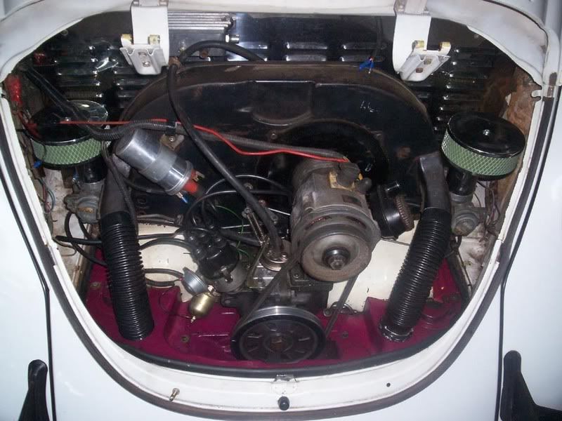

posted on March 5th, 2007 at 09:02 PM
the standard type 3 linkage works well on an upright with alittle bit of work
Joel
http://i128.photobucket.com/albums/p174/Buggin_74/twinsolex.jpg

posted on March 6th, 2007 at 05:49 PM
DUB74L. any chance of a closer picture of the centre linkage, and how you modified it.
