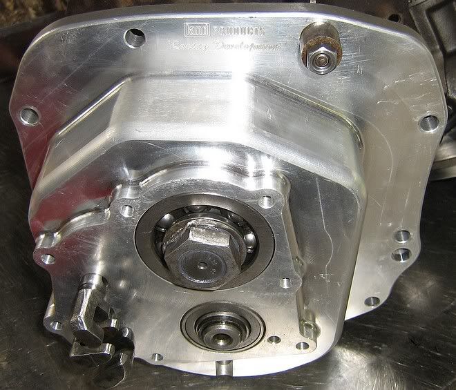

But I have decided to completely re-gear this tranny so that it more suits the All Motor type of racing that rod will most likely be doing in the near future.

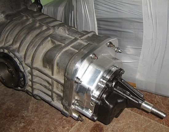

Also to be upgraded will be a LanD intermediate housing, to improve shift quality,
http://i113.photobucket.com/albums/n216/dangerous_05/IMG_3543.jpg
Special "Pablo" thrust arrangement,
http://i113.photobucket.com/albums/n216/dangerous_05/IMG_3530.jpg
http://i113.photobucket.com/albums/n216/dangerous_05/IMG_3532.jpg
and chrome-moly pinion nut.
nose cone thrust plate,
and an Albins steel side cover for the Vanagon cast diff.

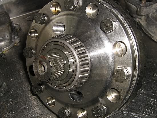

The spider gears that were damaged were replaced with some good used ones,
and all of them were bored in the lathe to get .002" more clearance to let more oil in.
Albins actually makes nice high strength versions for about $55 ea, but these only fail when the car does a one-wheel-burnout.

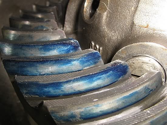

Once this was done, the diff could be reassembled, and a partial assembly done
to determine what shim was required to get a nice pattern on the 4.857 crownwheel and pinion.

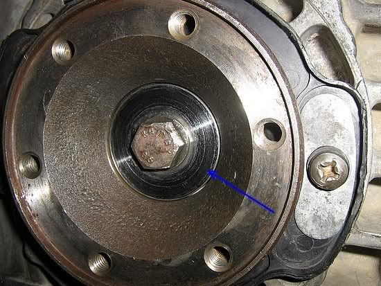

Once the shim was set and I was happy with the end floats of 1st and second gear,
I made up a solid spacer for between 3rd and 4th gear.
http://i113.photobucket.com/albums/n216/dangerous_05/IMG_3531.jpg
http://i113.photobucket.com/albums/n216/dangerous_05/IMG_3534.jpg
For circlip ended pinion shafts I normally prefer to use the stock sprung spacer,
but because I was changing over to a solid thrust set-up in the nose cone,
this was needed.
I should also add that the stock magnesium housing is probably not really strong enough to do this job,
but you could easilly bore the housning right through,
and use a tapered bearing and thicker version of the steel nose cone plate pictured above.
The 4th gear (now 1.04 ratio) was machined on its face so that it is nice and flat,
and also to locate an early beetle 1st gear thrust washer.
This will ride against a swingaxle diff thrust washer that is normally used to retain the side gears.
The 'snrub' is ground off to allow it to spin in the recess that I cut into the housing.
Must use the early version of this shim that is only about 3.2mm thick.
The more commom shim is about 4mm thick and would cause the recess to break thru into fresh air(=leak)
In the bottom f the recess goes some 36hp flyheel shims that are slightly ground down in their diameter to match the thick shim.
A 'poor mans posi' for the pinion.
http://i113.photobucket.com/albums/n216/dangerous_05/LanDAssy11ShimPackRotation.jpg
Lucky I have a stash of NOS 36er shims.
Clearance was set at 3 thou.

When converting to this style of intermediate housing,
there are a lot of beetle parts that need to be scrounged.
The best source for these parts in most cases is an early beetle(pre68 in this case).
Pete dug out an old core from behind the shed for these parts.
We use the following parts:
Early nose cone, studs and nuts.
(later one with seal NFG because the shortened hockey stick will not allow full engagementin 1st and 3rd)
Most of the time these will need re-bushing.
early bearings for mainshaft and pinion,
all the shift rods, forks, detent springs, balls and 'sausages'(no that is not rude).

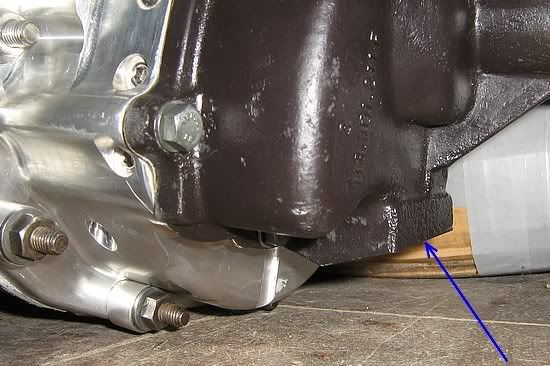

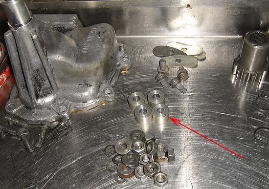

Also the housing studs will come in handy since the mounting flanges on these aftermarket housings are about 12.8mm THINNER,
requiring shorter studs(or bolts)
and these spacers for the lower mount(if the original is welded into the car).
http://i113.photobucket.com/albums/n216/dangerous_05/IMG_3536.jpg

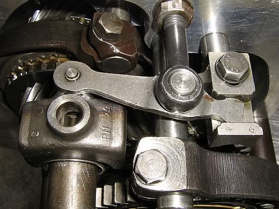

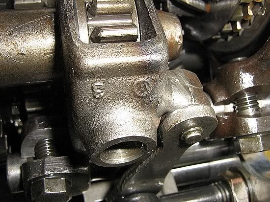

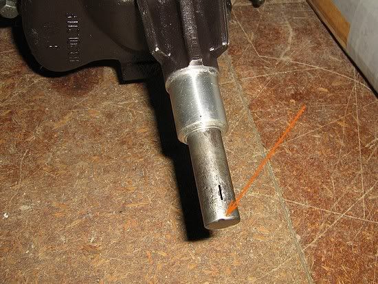

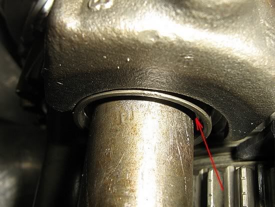

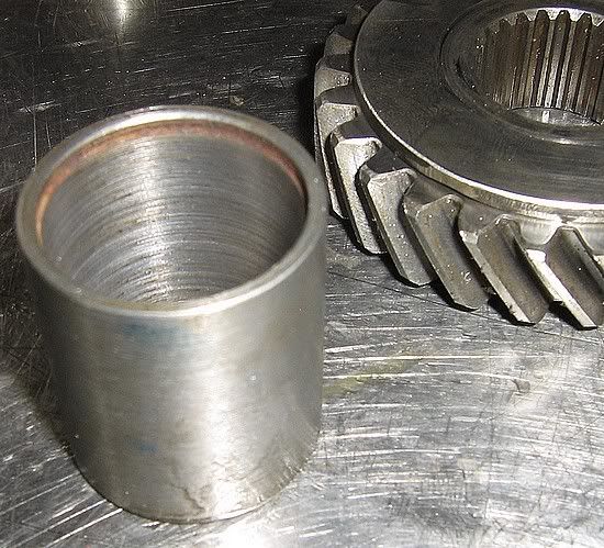

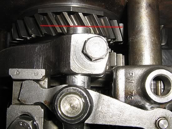

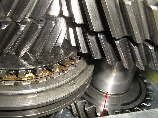

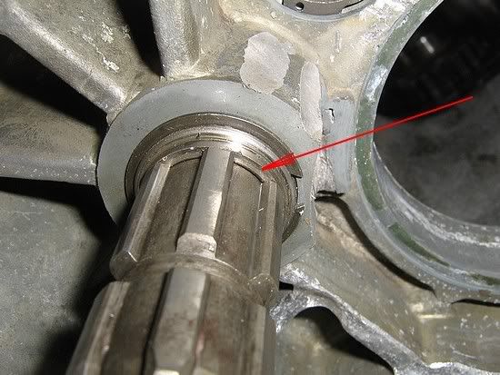

Another problem that arises is the reverse idler gear.
When using a late case,(2 lt one in this case), to get full engagement can be a problem
if you use the beetle brass fork and matching gear it bottoms out here:
http://i113.photobucket.com/albums/n216/dangerous_05/IMG_3540.jpg
I turned down the washer at the arrow,

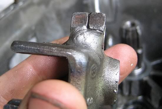

and I counterbored a bus gear and used a steel fork from a 1600 tranny.
http://i113.photobucket.com/albums/n216/dangerous_05/IMG_3541.jpg

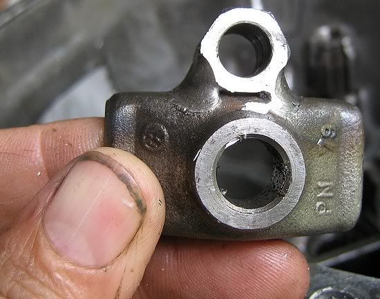

The fork required a modification to work with the (NOW) beetle reverse lever.
http://i113.photobucket.com/albums/n216/dangerous_05/IMG_3526.jpg
http://i113.photobucket.com/albums/n216/dangerous_05/IMG_3525.jpg
I reamed the nuts with an 8mm reamer from a flywheel/crank 8-doweling kit.
All set in the jig:
http://i113.photobucket.com/albums/n216/dangerous_05/IMG_3533.jpg
http://i113.photobucket.com/albums/n216/dangerous_05/IMG_3535.jpg
The advantage here,(and requirement), was that the taller 2nd gears(1.9286) rub on the beetle reverse,
but not the 1600 bus.
Also the bus fork is narrower in total width, allowing deeper engagement within the late gear case.
I could have used a late model bug or 1800 bus reverse, but then would have to change the mating gear,
and turn its OD down to clear the tall second gear.
This simple fork modification and counterbore machining allowed me to use Rods current reverse gear.
Erco also makes an aftermarket gear that wil be a bolt in no mater which reverse ratio you have(something like 21 different combinations!)

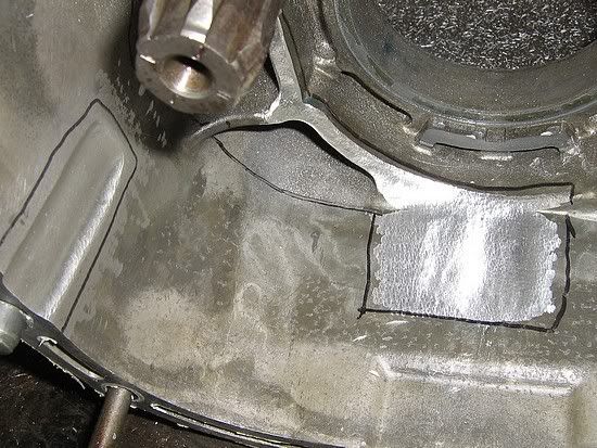

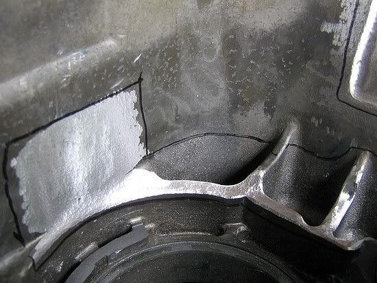

The next step was to clearance inside the gear case.
The Beetle forks and shift rods are on the other side of the tranny,
so there are a few areas that need work with the die grinder.
On later Beetles and Buses, the 1/2 rod passes through the case for support.
This extra support is unneccesary with the better material of this intermediate housing.
Also early Beetles did not have this support either.
With a pre assembly of the gears stacks, the excess shaft length is removed.

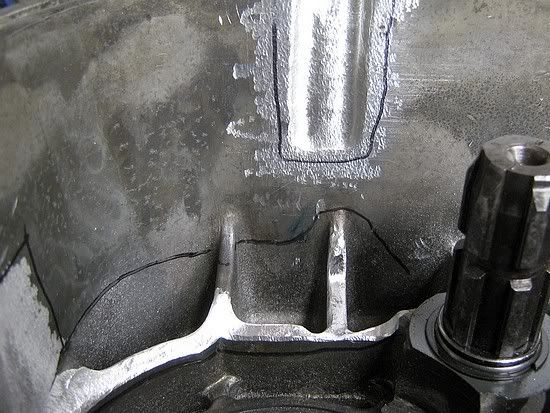

Then a couple of hours with the die grinder, trial and error fitting:
This area is for the 1/2 rod and fork:
http://i113.photobucket.com/albums/n216/dangerous_05/IMG_3520.jpg
This area is clearance for the reverse gear arm pivot:
http://i113.photobucket.com/albums/n216/dangerous_05/IMG_3521.jpg

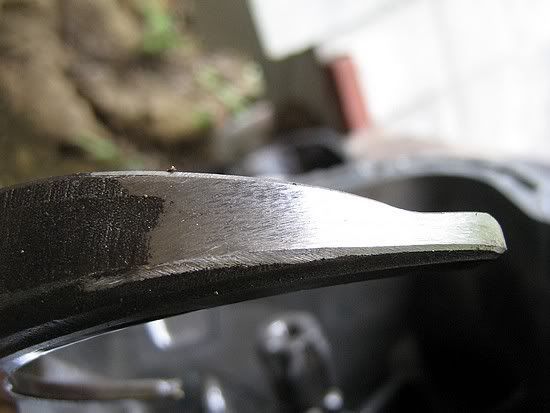

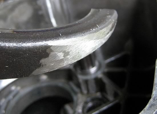

At pre-assembly it was found that the 3/4 fork required some metal removal.
This is an early 4mm steel fork.
On my own tranny I used a 5mm fork, and it required much more room than this one.
http://i113.photobucket.com/albums/n216/dangerous_05/IMG_3528.jpg

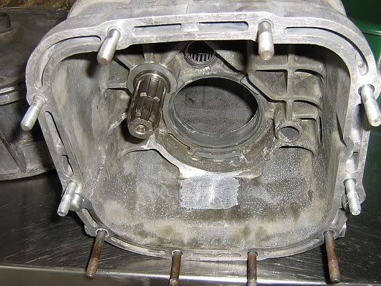

After a thorough clean out of the chips,
I added studs rather than using the original bolts that are used for assembly of the housing on 2lt cases.
http://i113.photobucket.com/albums/n216/dangerous_05/IMG_3539.jpg
Everything is washed and ready for final assembly now.

Well,
the chrome Moly pinion nut arrived from America
so I have been able to continue with assembly.
http://i113.photobucket.com/albums/n216/dangerous_05/IMG_3564.jpg
Here you can see the steel thrust plate:
http://i113.photobucket.com/albums/n216/dangerous_05/IMG_3567.jpg
I trimmed off the nose mount since it will not be needed,
http://i113.photobucket.com/albums/n216/dangerous_05/IMG_3565.jpg
The only thing remaining is to locate the dimple for the shift coupler.
It will be now about where the black mark is.
This is best done in the car and is fairly straight forward once a procedure is in place :
http://i113.photobucket.com/albums/n216/dangerous_05/IMG_3568.jpg
The end of the shaft is cut down from the standard beetle length,
because the bus crownwheel is larger and this moves the gear stack forward.
Bergs old kit used to come with a hockey stick pre-cut, but on mine the new dimple hole was not in correct index.
So by doing it in the car, I can get the index perfect with a simple vicegrip and electric drill operation.
The last mod was to make up some nice 4140 steel caps:
http://i113.photobucket.com/albums/n216/dangerous_05/IMG_3566.jpg
To give everyone an Idea on cost,
this particular transmission took me nearly 30 hours.
Being that it was very clean to start with, and required very few new parts,
you can imagine how much it would add up to if :
1. If it started off as a dirty old Kombi tranny,
2. If it needed new gears and bearings,
3. and shop rates that are out there these days.
(this is not a criticism of current labour rates, they are what they need to be, to stay in business).
