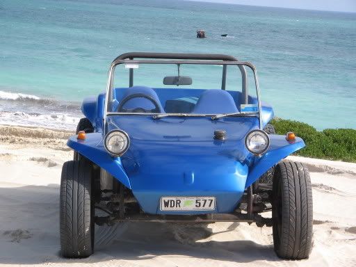

Here's a pic
http://i3.photobucket.com/albums/y96/64vwmark/alkimos%20run/IMG_0255.jpg
http://i3.photobucket.com/albums/y96/64vwmark/alkimos%20run/IMG_0258.jpg
http://i3.photobucket.com/albums/y96/64vwmark/mark.gif

PS It's the yellow one in the above picture.
