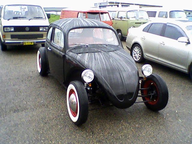

rod owner
anyone know who is the proud owner of this beauty
http://i54.photobucket.com/albums/g104/greedy53/Photo-0041.jpg

Looks neat im starting to really like these rods,Was it in the car park or the show,How was the swapmeet did the weather put people off??? cheers shane.

Flipped torsion bars, rachet springs, no hood area under the boonet, so don't how it would go with rego. Nice diamond weave interior and sweet paint.

the 'ratchet springs' are actually friction style shock adsorbers.
http://www.roundaboutmanor.com/airline/Images/LewPalmer/P0000049_50.jpg
the leading arm setup is the really scary bit. the trailing arms (and the steering arm on the spindle) are curved to be used trailing and even then they flex under load. using them in a leading arrangement would cause them to flex even more easily. :(
anyway, not my car I guess. he'll have to figure it out.

matt strong owns and built this car- a very cool looking car
posted on March 25th, 2008 at 03:40 PM
pls don't get me wrong ppl. the car is a beauty. matt's done some great work. I just wonder about that front end is all. :smirk:

I'd be more worried about some of the Rats that you are sharing the road with, not a beautifully-crafted show car like that
I love it - I drooled over it at Summernats

I doubt if it ever be allowed to be registered or if the owner even built it with the intention of registering it and driving on the road. Its a lovely piece of work so the effectiveness of the front suspension is only academic as it will only ever be driven around car parks etc.

the black paint on that rod was excellent....
it was in excellent condition all over...

My name is Matt Strong i am the owner of the black volksrod like Adam Debiasi above has already said, I spoke to an engineer before building the car and he was fine with me having a leading arm front end as long as it was all factory componets that i was using to do the job. i hope to have it on the road in the near future.
As far as the build of the car goes i built the car myself, i did all the cutting, welding, body work and paint, i sorted out the front end, bigger wilwood master cylinder and fitted disk brakes to the front that i had to make custom fit the car. I had some out side help from friends and family, i had the trim done by Rod Penrose, the motor is a 2376cc with comp eliminator heads and 48 webers that was built by shimo. The motor parts and the bling was also from Rod Penrose.( I would have done the trim if I could sew and I would have built the motor only I have not built big motors like this before, and it was a lot money to stuff up.)

Hi Matt, still not sure about the leading arm thingo (just my opinion, happy to be proved wrong) but good on you for getting it approved properly. The car is a credit to you. I expect the front will go alittle lower sometime in the future. ;)
