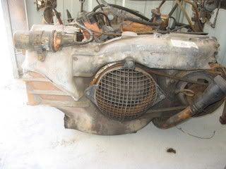

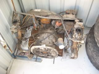

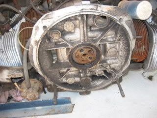

What engine is this??
Got an engine with my buggy and at the time was told it was a 1600. Have since been told it would be either an 1800 or 2lt.
Can anyone tell me what it is?
http://i198.photobucket.com/albums/aa248/gx_rex/March08186.jpg
http://i198.photobucket.com/albums/aa248/gx_rex/March08185.jpg
http://i198.photobucket.com/albums/aa248/gx_rex/March08184.jpg
Thinking of getting rid of it but dont wanna sell it as something it is not.
posted on March 27th, 2008 at 04:57 PM
looks like a Type 4 Kombi Engine either 1800 or 2 Litre
posted on March 27th, 2008 at 06:52 PM
yep type4
possible a 1800 going by the TDC sensor on the case
dont think 2L had these
posted on March 27th, 2008 at 07:14 PM
either a 1800 or 2l kombi for sure - not sure which but :crazy:
posted on March 27th, 2008 at 07:15 PM
whats the engine no stamped on it
that maybe a good clue..
Membergx_rex
Posts: 39
Registered: March 9th, 2008
Location: Perth
posted on March 27th, 2008 at 07:24 PM
Where would i find the engine no?
posted on March 27th, 2008 at 07:28 PM
its been a while but on top of the case from memory or there abouts..
it'll probably be covered with gunk etc.. have a good look around
someone on here will then have a book with MY and size for the case..
posted on March 27th, 2008 at 09:00 PM
There is often a number stamped on the fan housing, this may or may not match the actual engine number which is stamped on the crankcase rearward of the breather chimney visable from above.
Membergx_rex
Posts: 39
Location: Perth
posted on March 29th, 2008 at 10:36 AM
From what i can see engine number is CJ012341
Does that sound right?
MemberElusiveStranger
Posts: 330
Threads: 30
Registered: May 28th, 2006
Location: Kent. England
posted on March 29th, 2008 at 10:50 AM
CJ engine code's a 2 liter 8/75 ->7/79 70 odd BHP from the factory.
It may not be stock though... the 1800 heads were meant to turn this puppy around if installed onto the 2000 B & Ps
