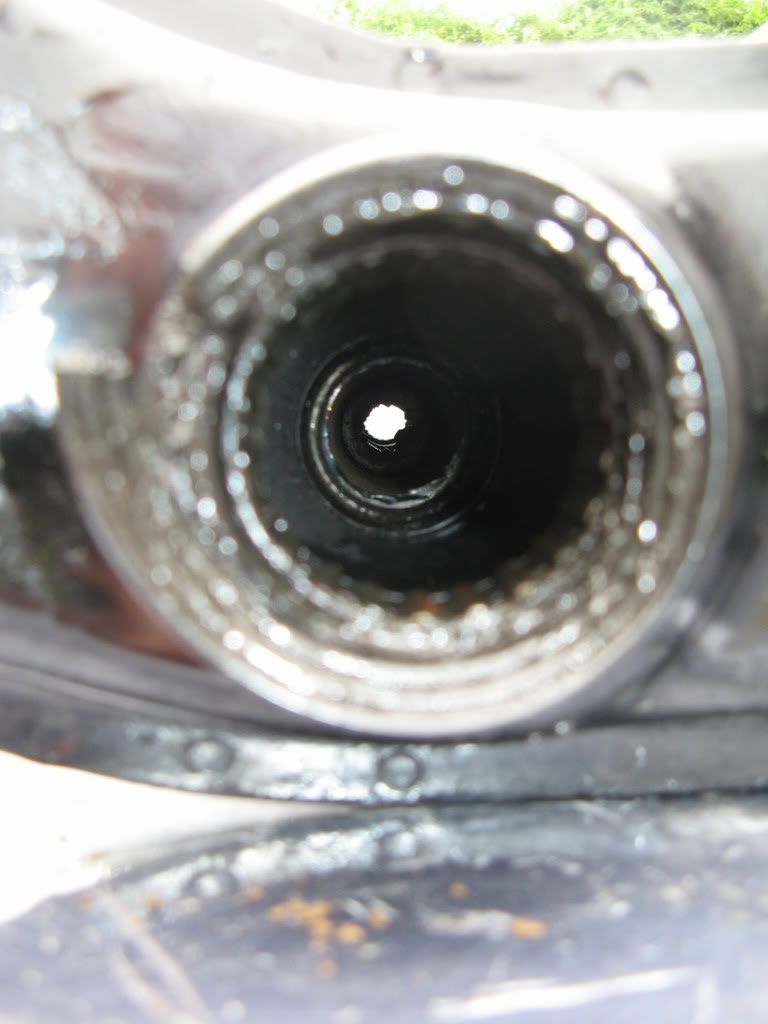

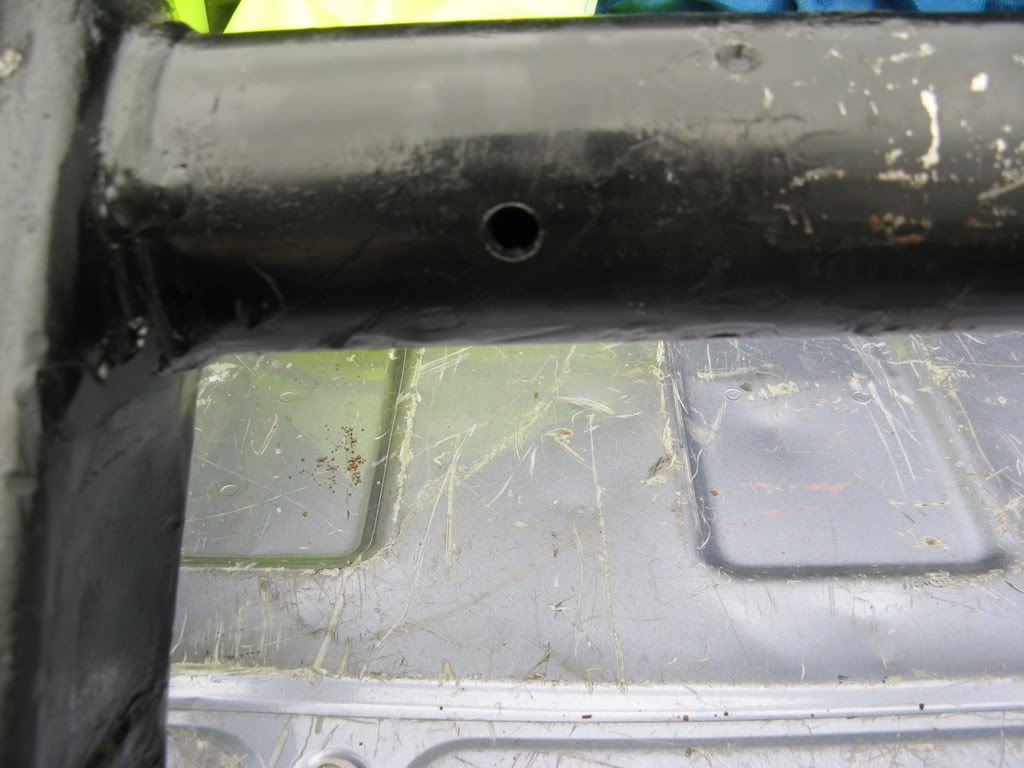

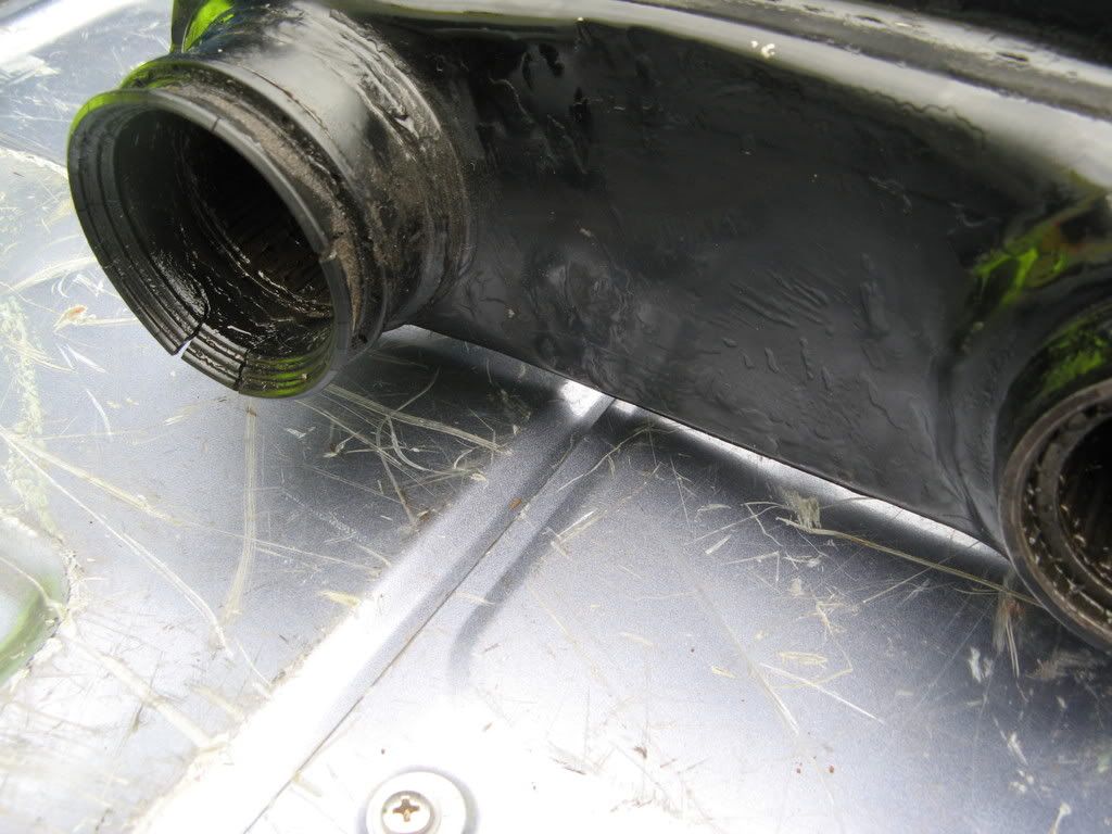

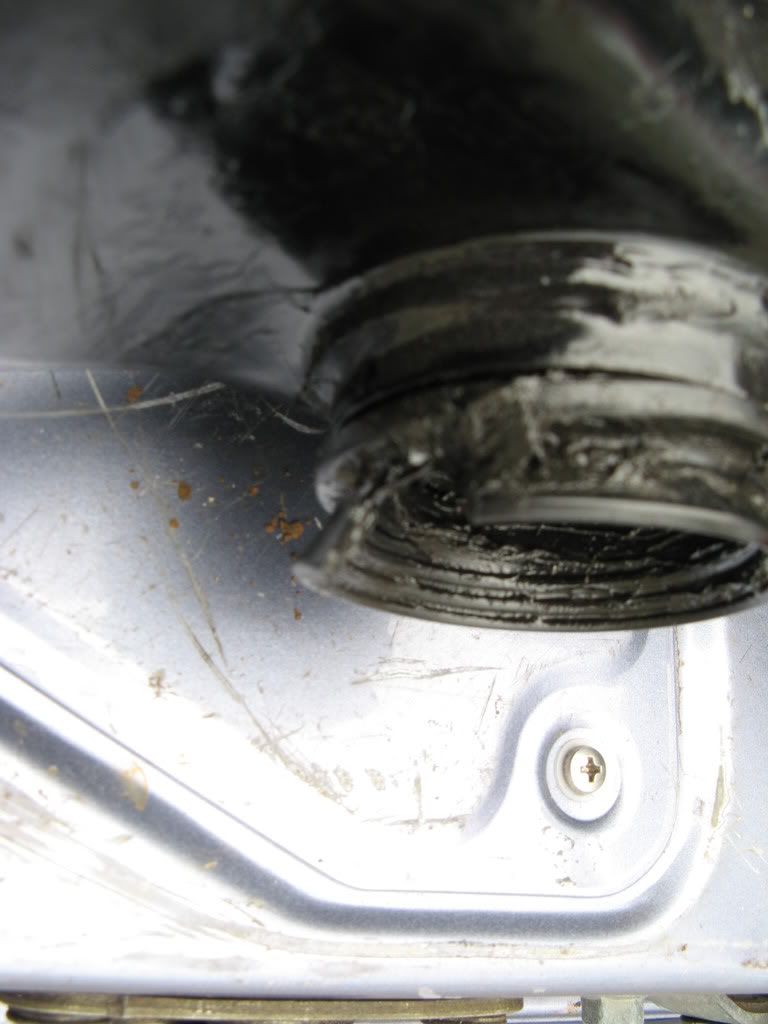

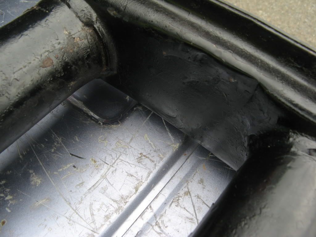

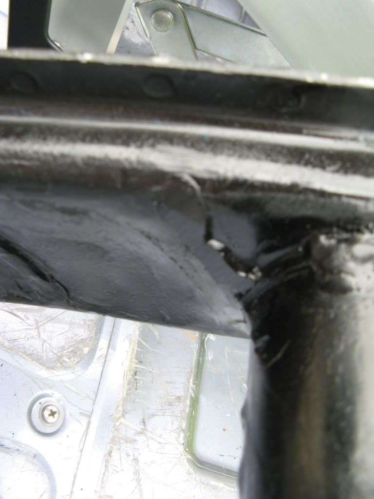

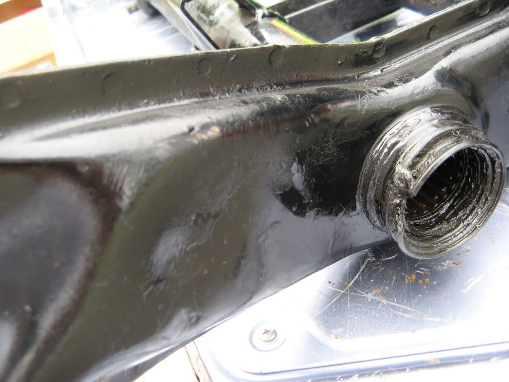

Would you accept this for $900

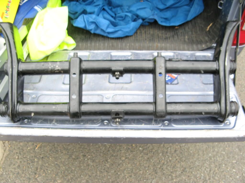

Below are photos of a beam i got installed by a well known Sydney VW shop. I was informed that this was the best beam and best option. I also paid for them to install it as my time is tight and i assumed they would do a perfect job.
Once this beam was in my RHS wheel was right under the edge of the guard while my LHS wheel was tucked in. There was a difference of about 1inch. The rubbers on the trailing arms were frayed.
I was alarmed.

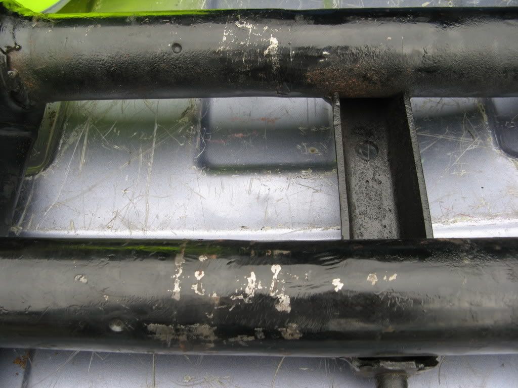

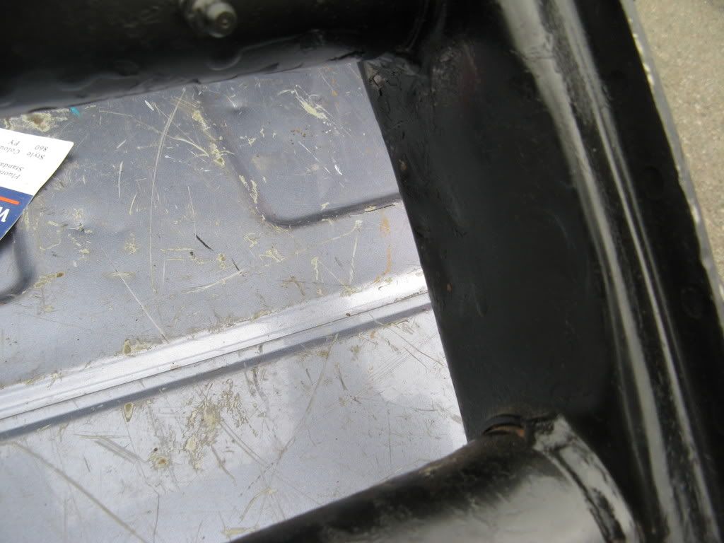

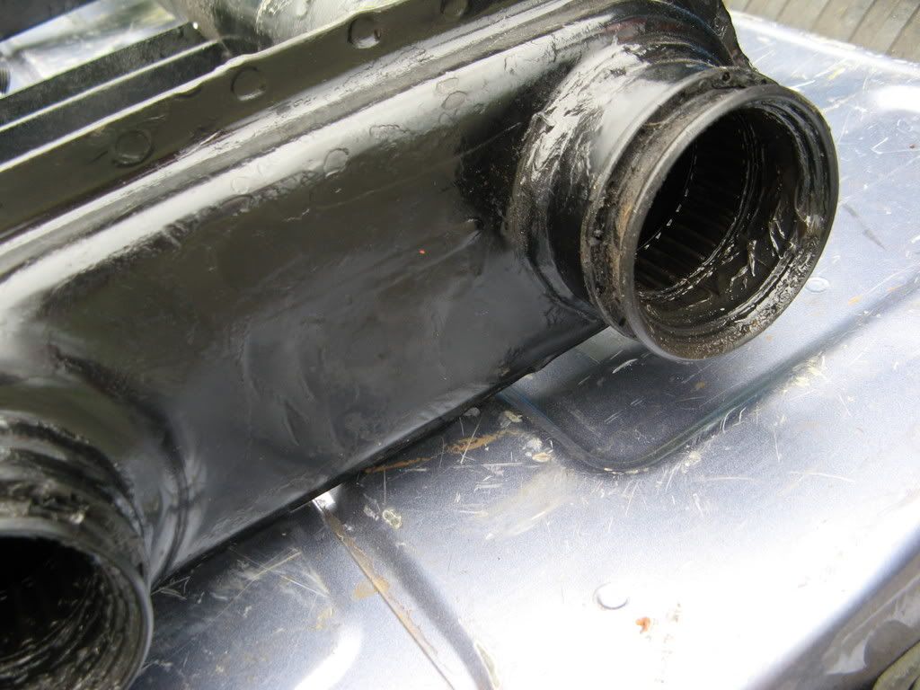

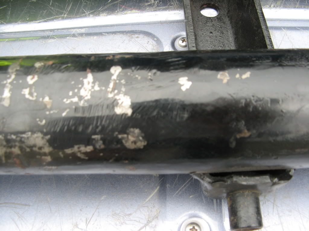

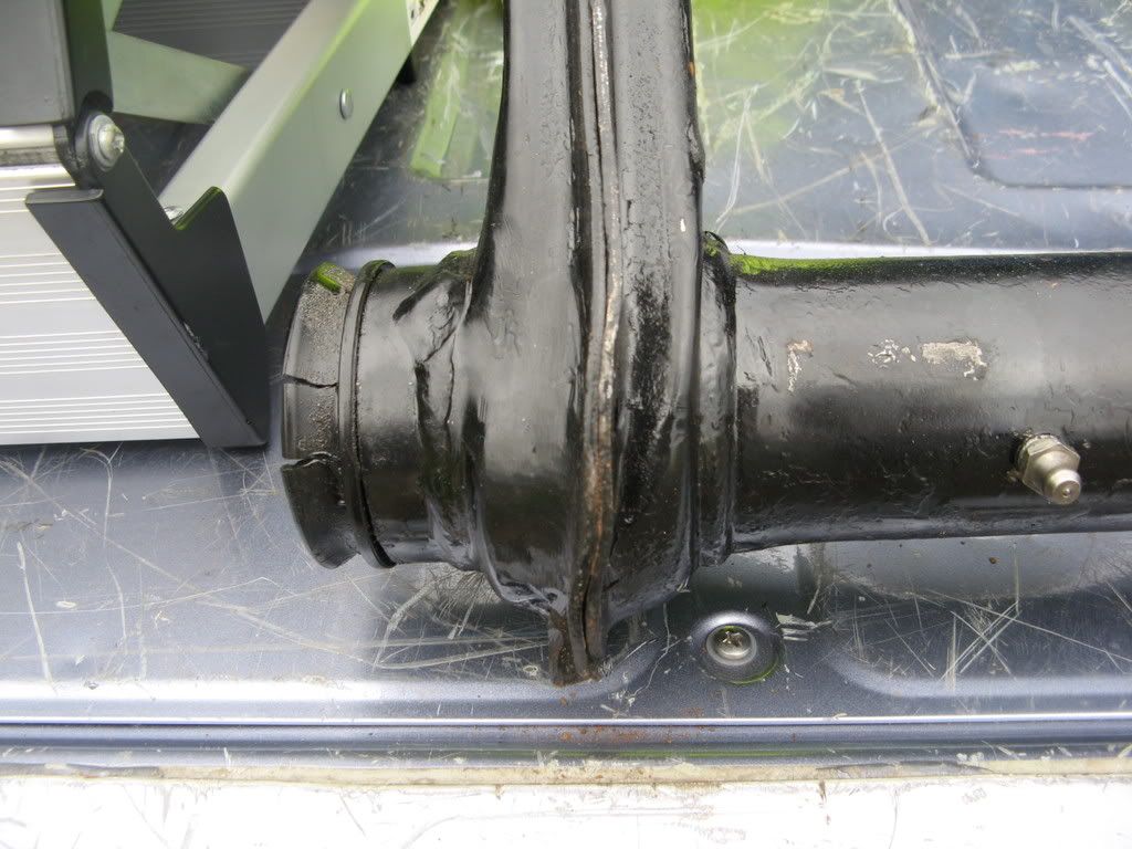

After closer inspection the driver side of the beam was badly beaten as were other parts of the beam. The black paint was also painted over the grease that had built up on this beam.
After taking the car to a different VW shop to get my windows put in, they too were alarmed and disappointed by the condition of the beam.
I removed this beam myself to put in another beam bought from a different VW shop. On doing so i found that the beam was DRY!!! No grease!!! Also, the nipple on the top driver side was not there and this was because the steering box was positioned there, so they thought 'o well, stuff greasing it, we'd have to make a new nipple hole'
On removing the beam it was clear that it was warped. Once i installed the new beam myself, the wheels were in the correct position.
What do you guys think of these pics?????

i can see those. um thats a pretty poor job to come out of a Professional shop, i would want a full refund.

I see them now! To me it looks like a quick job rather than a good one. A little bit of attention to detail and it shouldn't have been too much of a drama to get right and satisfy the customer but that's a sign of the times. Take it back but good luck.

The best they could do me was $450 out of $900. I lost out on the labor, plus was back charged $100 because he used 'cut down steering arms' (the beam was 2inch narrowed) and torsion bars. I needed to use those on the new beam i got and installed, but he thought it fair to back charge me for them...

you payed labour for a professional job not a backyard job, thats poor. good luck with the rest of the car love the work your doing to it.

also from your picture it looks as though they have shortened from only one end then moved the supports, the weld looks nasty :( talk to Dyno at Custom Vee Dubs, he did mine and I can guarantee that he did not need a grinder to tidy up :)
http://members.optusnet.com.au/s0411400342/555bug.jpg

mmmm interesting workmanship but I have a few questions for you:
1. What did you pay for ? Was it a full reco ?
2. Did you supply the core or did they do it outright for you ?
3. Is this the same shop that told you it was not legal to have a single adjuster ?
4. Was the $900 that you paid to cover just the beam or was that what they cost you for a drive in / drive out service with them supplying the narrow beam outright and the labour to fit it to your bug ? On the invoice did they itemise what you were getting or just a single line ?
5. Did you have a good look at the leaves before you re-used them ? and where the tie rods shortened correctly ?
Brad

I paid for supply and installation. $550 for the beam, $350 for labor. They did not re-use my beam, it was a beam he supplied all on his own. The leaves were checked by the VW shop i bought the new beam from (the one i installed myself). The tie Rods seem to work ok, but ill get them checked.
Yes it was the guy who told me one adjuster was illegal.
