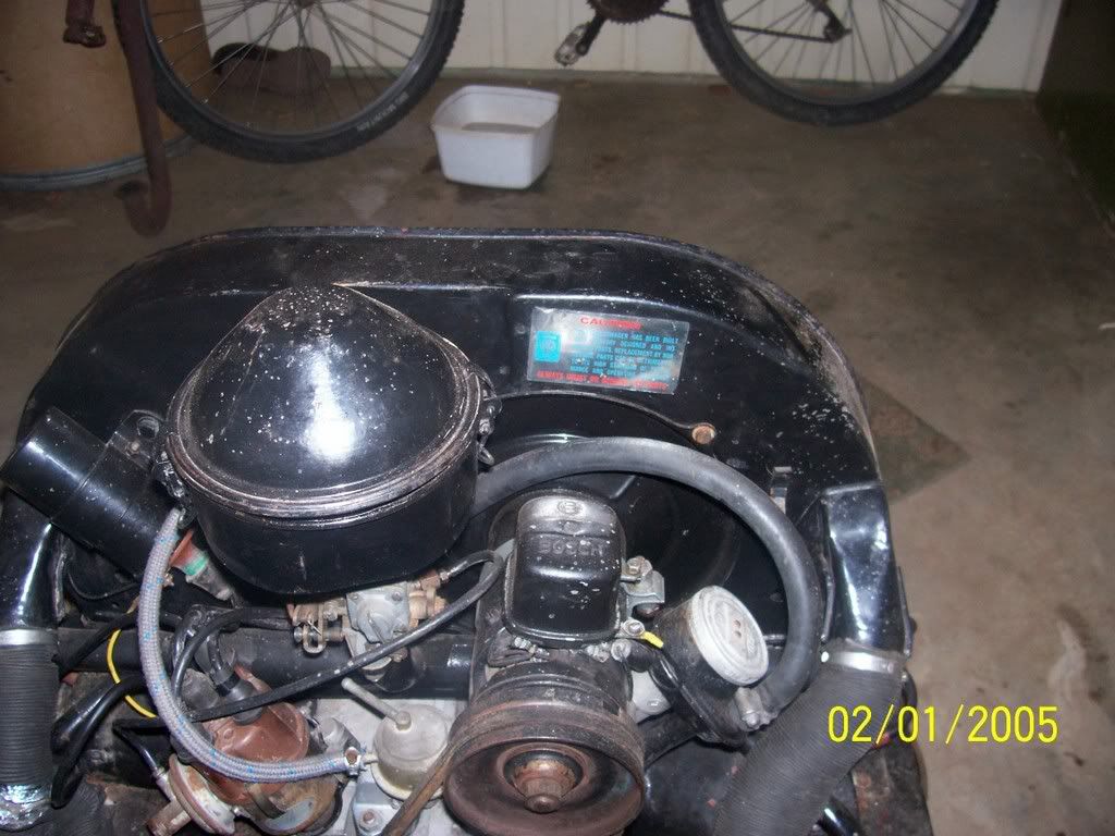

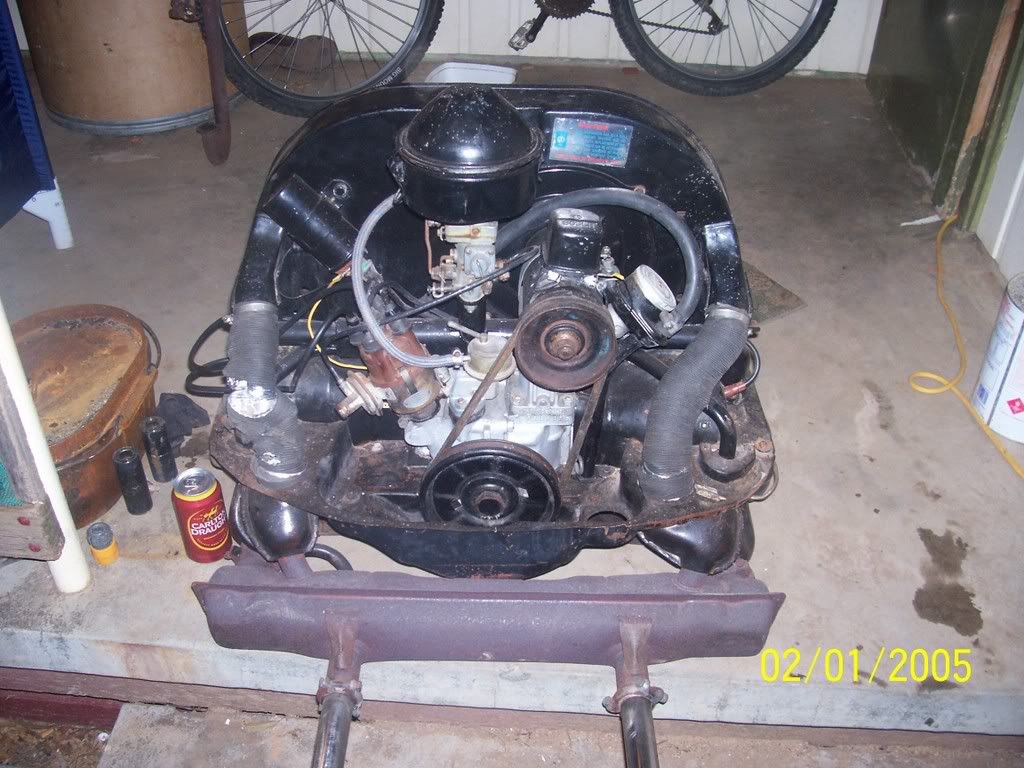

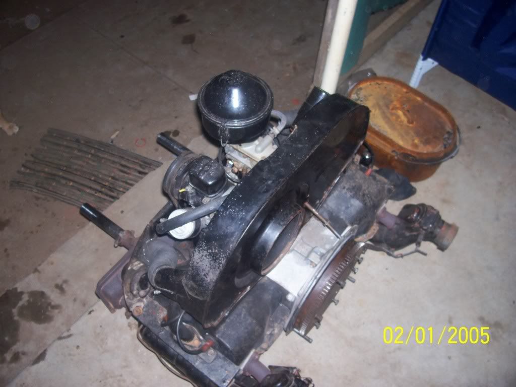

1200
yeah i sort of thought that would be the case. All of the 1600 i have looked at have been worn out peices of shit the only reason i want to do it cause it seems to be in good condition
http://i289.photobucket.com/albums/ll219/74vw/1200engine2.jpg
http://i289.photobucket.com/albums/ll219/74vw/1200engine3.jpg
http://i289.photobucket.com/albums/ll219/74vw/1200engine.jpg
WANTED 1600TP IN GOOD CONDITION .MUST BE IN S.A. AREA
posted on May 11th, 2008 at 07:16 PM
WOW
thats one nice and clean 1200 engine....
You need to remember that the VW gearbox is really a transaxle as the DIFF is inside it...
and the 1600 diff has a very high diff ratio...
i think 3.88 to 1
where the 1200 had 4.375 to 1..
so it would be pushing the 1200 engine....
just not enough horsepower..
You could fit 13 inch rear wheels... lol...
Lee
posted on May 11th, 2008 at 07:29 PM
Joel,
that was one rusted engine bay
yikes...
Lee...
posted on May 11th, 2008 at 09:33 PM
it was in a bug that just about to be put in the car crusher
it had been sitting around unused for many years
to further make that 1200 strugle pushing a late bug around is the fact it has a 36hp carb and distributor which would be to small for it even in a standard 1200 let alone a high geared late bug
