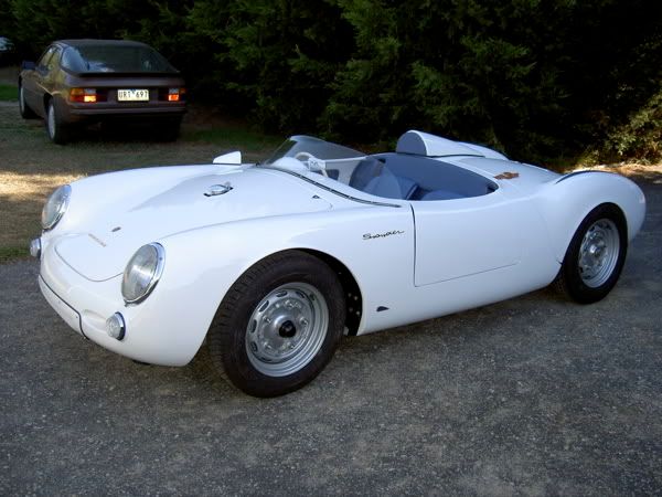

I have just finished getting a McRae 550 spyder restored which originally came from NZ. I can assure you the ADRs will kill you if you are looking at bringing in a Chamonix from Brazil. Peter in Sydney who is the importer for Chamonix in Oz had to jump through a lot of hoops to get them compliant and on the road. There are many builders in the States - Beck, Vintage, Thunder Ranch, Fibersteel and the list goes on, but you will have many issues trying to bring it in as the powers to be see it as a current build. Then you will have to deal with DOTARS which is a nightmare in itself to get it approved to bring in - it has to be 30 years old for a personal import (from memory).
The best way is to try to find something here and registered - around when ADRs came in - 1968 and then at least you can make it look like a car from 1955 instead of a compliant car of today. This probably explains why there is less than a dozen 550s in Oz - good luck!
