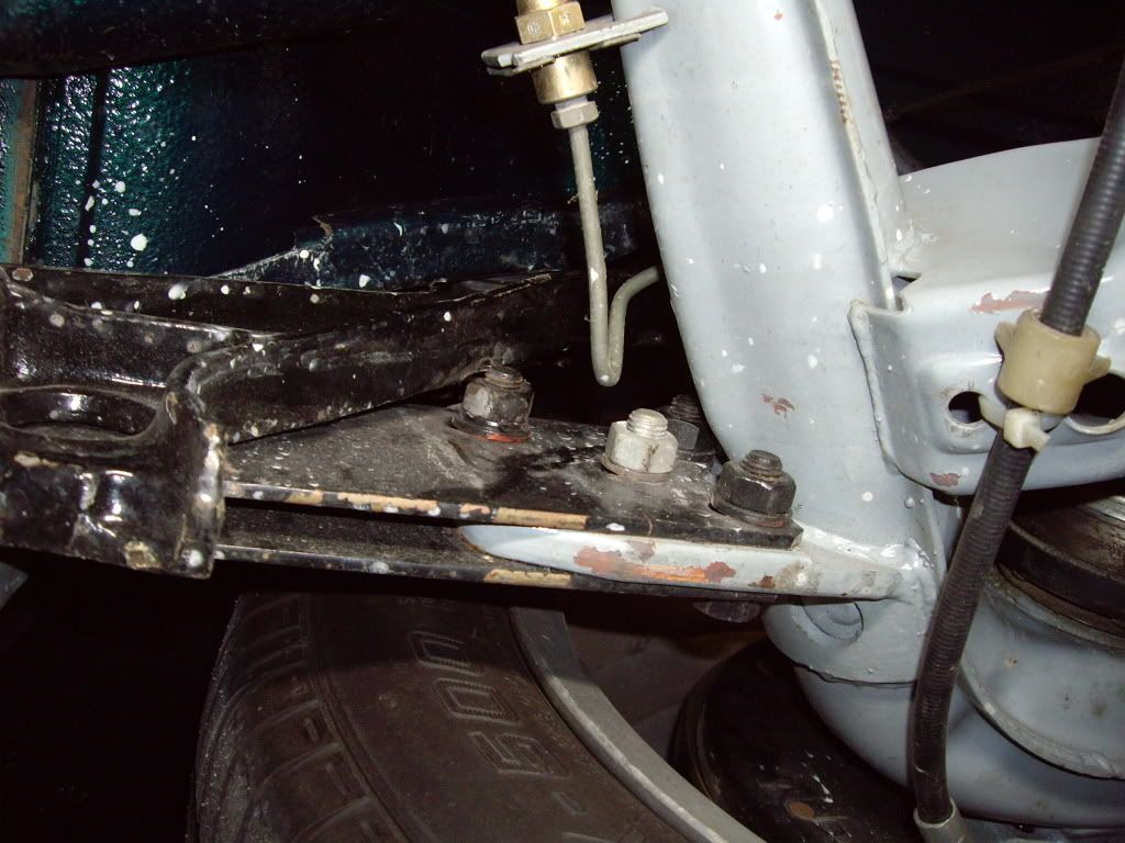

Can you spot whats wrong with my suspension??? (photo)
Well, as some might know, i've had this painful rear end suspension issue since i got my bug on the road.
Checked shocks, removed sway-bar and then left it for a little while as i was told the car needed to settle in.
Still no good after 2 mnths or so, so due to limited resources at home i thought i'd check with a couple of the vdub shops. We went for a drive and i mentioned the bottom out/banging noise always came from the right. I was told that the rock hard feel and banging was normal due to the low stance of the car, gas shocks and wide rear tyres. So i was informed to raise the car, change the shocks and sell the wide wheels and fit 6's.
Now you can tell from the photo what the problem is/was (i hope!). Luckly i didn't do any of the above.
I know the 'experts' can't see everything and know everything, but the moral of the story is - That its your car and you probably know best as to whats normal or not. I'm just annoyed i didn't see it earlier. A simple trip up a hoist would have revealed it. Again, it's not really the shops fault they didn't see it, just make sure you go with your gut at times, to double check things.
Wonder if anyone else has similar stories?

This is a shot of the back right of my car, looking from the ground up - can you spot the problem???
http://i272.photobucket.com/albums/jj188/Mick058/IMGP1713.jpg

You have double spring plates from a type 3 or Autostick. The bolt closest to the torsion housing is supposed to be short and not have a nut on it. It is meant to just screw into the trailing arm hence the annoying clunk in your rear suspension as it hits the shock absorber support.

u can see where its been backin on ur shock absorber mount
yep, the other side i think is threaded

Sooooooooooooooooooooooooooooooooooooooooooooooooooooooooooooooooooooooooooooooooooooooooooooooo much better.
Can you see how much travel there was? Like 20mm...bang, bang, bang. Very annoying. Try taking a left hand turn!
We found this the same weekend we installed the kafer bar and re-torqued my now worn in (1500k's), ready to drive and scream Pobjoy engine. So i am very happy driving it at the moment.
