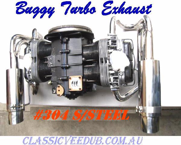

i had 2 cannons, one each side
basically home made version of this but down low to fit a bug with some hacked up J pipes
http://www.classicveedub.com.au/images/SpareParts/best_cvd/IMG_0607.JPG
loud was the problem, sound was fine, unequal lenght headers gave it that choppy WRX note
it got really droany at about 3k which was right at hiway speed, one trip to the goldcoast was enough for me to rip them off when i got home
the kinda rumble that really hurts your head
i can only imagine that a single one would be louder again
there still in mum and dads shed somewhere i think
altho my bug was pretty low at the time so the bottoms are dragged off them and theres lots of ugly hangers welded to them..... i hate welding stainless

that first one is just a monza with only one outlet instead of 2 without the totally awesome 4 chrome tips :rolleyes:
i would run a stock peashotter over 1 of those
cannons leave u with sweet FA ground clearance, hence why mine had the arses dragged outta them
