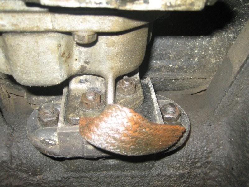

How can I tell which mount that I have? Is it dependant on the year of the car (mines a '56)? Are you saying that I may be able to bolt a later gearbox straight in??
posted on February 10th, 2009 at 01:08 PM
take a pic of the front of the gear box and post on here theres a wrap around type mount anda bolt up type
they varied from model to model depending on what was in stock
posted on February 10th, 2009 at 01:09 PM
it would be easier to remove the box and weld in a later style mount
rather than trying to find a hens teeth Kombi nose cone if you have the wrap around front mount

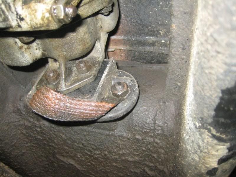

I have taken some photo's and will post them below...
http://i103.photobucket.com/albums/m153/aussie1977/IMG_4013.jpg
http://i103.photobucket.com/albums/m153/aussie1977/IMG_4012.jpg
http://i103.photobucket.com/albums/m153/aussie1977/IMG_4014.jpg

posted on February 11th, 2009 at 06:48 AM
Thats the later style mount not the wrap around
so a later gearbox 40hp tunnel type or 1500 swing axle will slip straight in
NO Kombi nose cone required

Later box will go straight in on that one.
The early mount on some early 56 and down have a wrap around type mount No2

posted on February 11th, 2009 at 08:28 AM
as far as i know and have tried you only need the Kombi nose cone with the wrap around front mount
I have fitted a few with the mount as per above its the same as the later style
as i said above theres dosent seem to be any logic to the wrap around mount they appear to be random in different year models up to when the tunnel gearbox came in

posted on February 11th, 2009 at 08:34 AM
The wrap around mount is listed to suit cars up to 59 , i've never seen them in cars over early 56 but i'm guessing other countries may have used them later.
