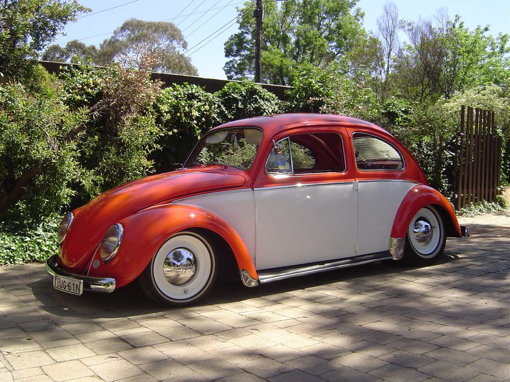

I'd like to do the same profile setup and use porta walls the same as the front of this bug
http://i235.photobucket.com/albums/ee174/timmyj_p/bluebug.jpg
I've been told by a lot of tyres places that it's impossible to get any smaller than 135 x 80 profile for a 15inch rim.
But I constantly see guys running 135 x 50 -55 on 15inch rims.
Anyone know where i can find a place that does nice skinny tyres like the front of the blu bug???
got any more pics of this bug?
it looks familiar

And no, that's the only pic i have of the blue bug. I wish i had more! It's such a sweet ride.

that front setup looks sweet!!! Love the bullets :)
I need the 135's because of the skinny rims that will be up front and am going to have porta walls on the rear, so kind of want porta walls on the front to match.
Haven't seen the porta walls on a 135 up close, but they always look sweet in pics. I just hope they don't end up too far off the rubber.
