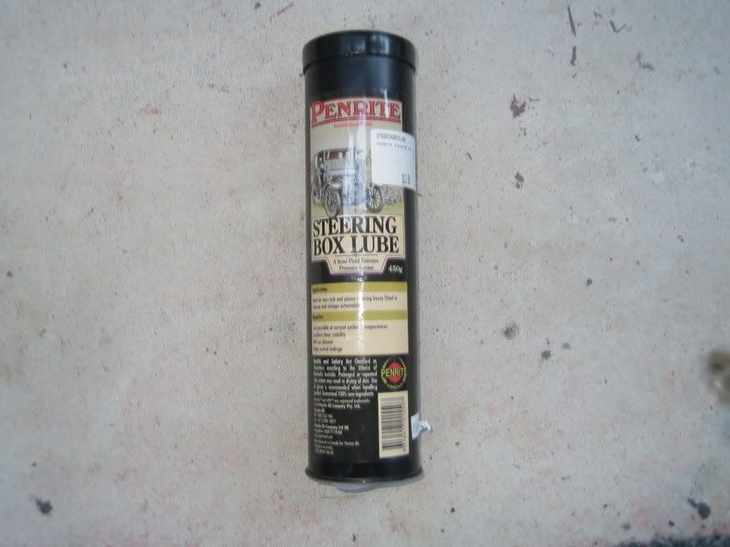

Sometimeman,
Penrite make a proper steeringbox grease, you'll probably have to order it in.
Here is a link to a discussion over at DSK about penrite grease and the pros & cons of using grease in VW steering boxes.
http://www.dsk.com.au/forum/viewtopic.php?t=7881&highlight=steering+box+grease
http://i21.photobucket.com/albums/b280/beerdoc/Steeringboxlube002.jpg

Thanks Matt, That seems to be what I'm looking for as I feel the box is Ok except for the weep.
