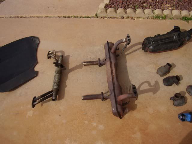

This is what we have been talking about. Two heat riser tubes on each side. They came on late 1600 and 1300 twinport engines. I think the idea was to get more volume of flow, thus reducing the tendency to clog up with carbon.
Mufflers to suit are getting impossible to find.

posted on June 21st, 2009 at 09:12 AM
this pics been getting a good run for its money lately :lol:
in the mid 70s to try and combat carb icing probs in colder climates vw introduced a new inlet manifold that had 2 sets of preheat pipes
the dealership bulletns i have call them twin hotspot and the old style single hotspot
in aus they were only fitted to the 76 flatscreen bugs and a handfull of the last 1300s apperently
Ive been around plenty of 75Lbugs nearly all with original engines and have yet to come across one with one so you wont see to many of them in existance
they also had to have a redisgned exahust, breastplate and manifold sealing plates as well
http://i226.photobucket.com/albums/dd191/boostedbug/my%20other%20bugs/manifolds.jpg

Hi Matt
I didn't know such a thing existed...
I thought they were only on type 4 engines...
and I've never seen any mufflers like that...
looks like it was a good idea... as singles do seem to be clogging up these days... and its hard to tell unless you blow thru one end...YUK...
I've been trying to think what I could pour thru them to make them non cloggable?? rust free...
My original actually rusted right thru and was blowing exhaust over the fan shroud... Welding it up didn't help with the flow of hot exhaust thru it....
LEE
PS: WOW... I'm still learning about Beetles after 49 years of interest in them... My Dad had beetles & Kombis...
Looking at it there seems to be a high pressure take off on both sides and a low point exit pipe on both sides.
They must be seperate pipes.
I think the reason would be to get the same amount of heat (well - in effect twice the heat) but travelling from both directions
I cant see why they wouldnt clog up in the same amount of time.
Just you now have two pipes to clean

Yeah,
That sounds more likely, I was just having a guess. They look a lot harder to unblock too!
RED62E
The mufflers are hard to get new. They weren't in production from the factory for long and after VW stopped supplying them as a spare part I don't think it has been profitable to reproduce them as it is so easy to convert back to the single style because "everyone" makes those.
There's probably NOS ones floating about in Europe but I've never heard of reproduction ones.
For the same reasons, I doubt if you could get the inlet manifold and tinware new either.
