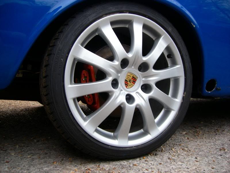

I'm running early 944 brakes all round on mine, also fitted the porsche master cylinder to mine too. Makes for an awesome set of brakes but you'll have to go for the Porsche rims too.
The master cylinder and rear brake setup are almost a bolt on affair however the fronts do require abit of engineering to get on.
IMO well worth it.
http://i16.photobucket.com/albums/b37/redevol/Type%203%20Blue/SANY0401.jpg
http://i16.photobucket.com/albums/b37/redevol/Type%203%20Blue/SANY0400.jpg
