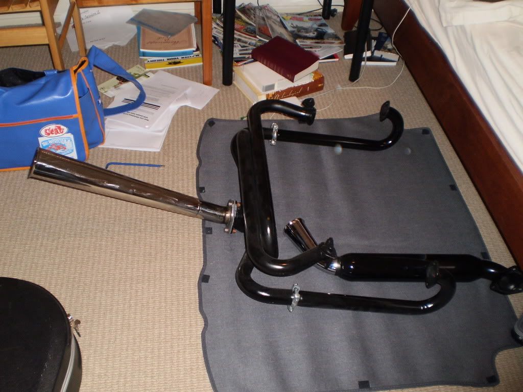

and they sound awesome :) I got one fro my thunderbird from action day, spent 2 hours cleaning it up.. and it looks sweet... under my bed with the rest of the exhaust. :) all ready for the set up!

I nearly tripped over Craigs on the dray rat at action day....... don't tell him.
Awwwwwwwwwwwwww YEAH!
http://i662.photobucket.com/albums/uu341/jason_aniolkowski/P9130263.jpg
Pardon the messy room... lots of assignments going on. hahaha
