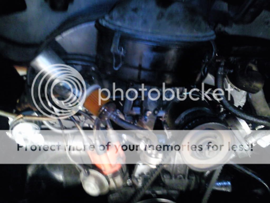

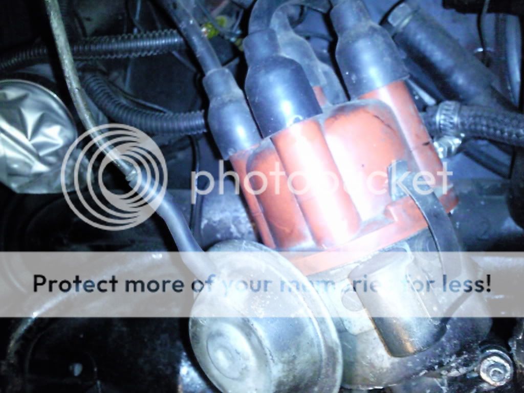

He said that i need a vacume advance? I have this dissy dunno what it is but yeah, Its a 34 pict 3 on a 1600 single port. srry bout pics, but its night time.

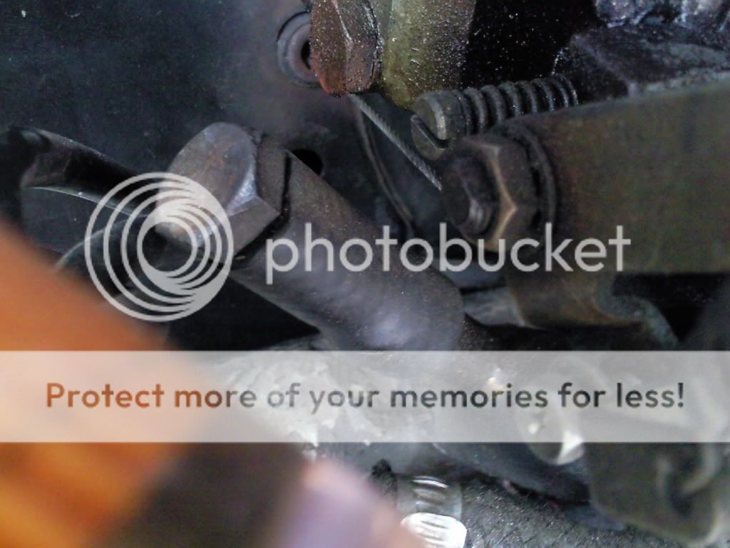

And here is a pic of my nosecone mount, is it stuffed?
http://i626.photobucket.com/albums/tt347/71-BEETLE-SEDAN/Photo0237.jpg
Membergrumble
Posts: 2671
Registered: June 10th, 2008
Location: Taree
Mood: happy all the time
posted on November 12th, 2009 at 08:15 PM
Is he telling you that the Vacuum advance diaphragm is leaking? I also suggest that you move the fuel filter from its current position as it is a prime cause of a fuel fire,move it under the car.Cheers Les
Member71-BEETLE-SEDAN
AKA Josh
Posts: 1058
Threads: 108
Registered: March 25th, 2009
Location: Mittagong NSW
posted on November 12th, 2009 at 08:25 PM
His words were that its not holding vacuum. Siad i needed a new bit on the side of the carbie.
Fuell filter will be moved when i do the oil.
also in the backgound of the second pic there is a rubber hose off the side of the carb, why does it have a bolt in it?
posted on November 12th, 2009 at 10:19 PM
Yes, fuel filter in the engine bay causes burnt out beetles...
I hope You carry a fire extinguisher just in case..
the vacuum advance can on the side with the small hose going up to the carburetor...
on the arm that goes into the distributor from the can will have a number on it... to identify it...
they are very expensive..
that's why many beetles have the el cheapo 009 distributor without any vacuum advance..
I have been using a Bosch 009 on my 1600 single port for 4 years without any problems...
I have however just bought a new SVDA 034 distributor from the USA to replace My 009 in the future...
I also have the pertronix ignition to replace the points..
You can buy the complete system - single vacuum dual advance distributors new... they are chinese copies, so I'm told but have been used without any problems..
You need to buy some workshop, owners, and operator manuals for your beetle so You can at least change the oil,
and maybe tune the ignition [points] and adjust the tappets...
You would need to buy tools also...
the late Gene Berg said "the best person to work on Your Volkswagen is You"
LEE
http://community.webshots.com/user/vw68autobug
