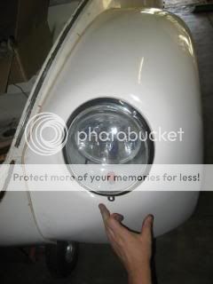

I've only just put a set of those projector lights above in my bug
I'll put better info and pics of them in my readers thread to save hi-jacking this one but I'm pretty happy with them and I'm very fussy when it comes to lights
http://i128.photobucket.com/albums/p174/Buggin_74/Lbug/headlights018.jpg

posted on August 15th, 2010 at 09:36 AM
Hi Lee, theyre a brand called Neo-lite and just use a standard p43t base H4 bulb - I hate lights that use the VW only p45t bases, so hard to get new bulbs from anywhere but a VW place
Although I do have a 6000k HID xenon kit sitting around I might try in them.
The only way to run a HID system that's safe for other motorists is to fit them to projector lights.
Pretty well all new cars now run projector headlights so I figured they were worth a try, I'd tried those crystal prism inserts like that orange bug above and they were a waste of money.
they look great and work fine if you have a car you never drive at night but I think the screen on my phone throws out a more focused beam.
And they were so cheaply made, all plastic, one cracked around the outside when I tightened down the retainer and another fractured when it copped a rock.
These new ones are thick glass lenses with metal reflectors like the originals
Low beam is a bit vanilla, an ok kidney shaped pattern but highbeam is where they really shine...literally
I reckon they have double the beam range of normal headlights, but i guess thats the effect magnifying glasses tend to have
They like those crystal prism ones don't directly fit an aussie vw, you need a sealed beam bucket mount from something, I've got old Lucas ones from a Morris Minor in mine
I also had to go back to my original plastic headlight rings, which are still chrome... yay more painting to do :rolleyes:
the Brazillian metal ones i had didnt clear the mounts
