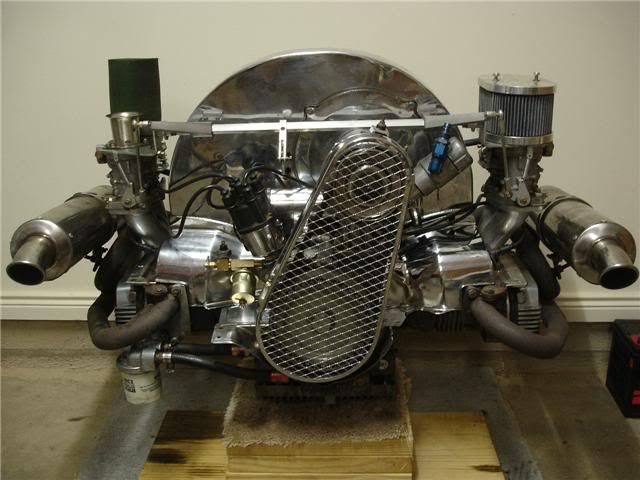

How's this for white, same guy owns the Alloy/chrome too. Tony LOVES cleaning. you should see his tidy workshop:love::love:

that white would suck to keep clean!

Man - how scared must that little oil filter be, sitting out there on it's own, all unprotected like that ?!?! (last pic)
