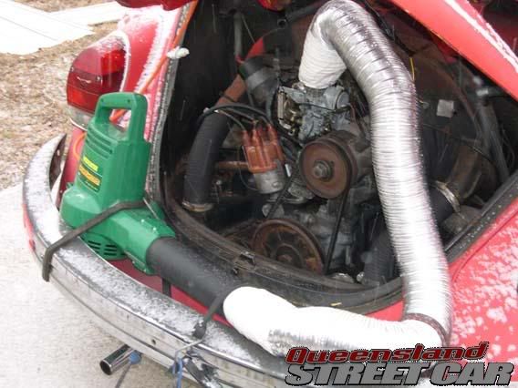

posted on April 26th, 2010 at 09:52 AM
just adjust this cold start fan to blow hot air down heater tubes.:no::crazy::no::crazy:
http://img.photobucket.com/albums/v419/montem/post-9-11177036334.jpg
:lol::crazy::lol::crazy::lol:
