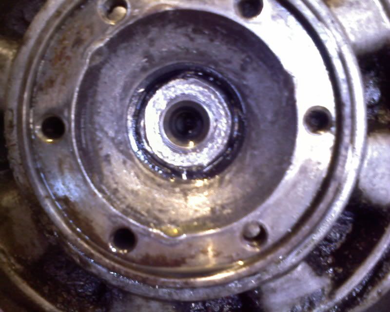

Hi,
Just getting an L bug IRS gearbox (AT code), and noticed the seals inside the flanges look to be broken. I have an S bug box as well, and that has nice plastic covers inside the output flanges. Are these needed? Do they stop geabox oil leaking there or something?
Thanks
http://i8.photobucket.com/albums/a8/tufty65/IMAGE_490.jpg
posted on June 7th, 2010 at 08:59 AM
Yes, those seals keep the trans oil in. Can bodge with silicone only as a tempory fix but the seals are easily fitted using a large drift the correct size (a large socket will do).

posted on June 7th, 2010 at 11:56 AM
Thanks Matt, hey where would you buy them from in Australia?
Thanks
posted on June 7th, 2010 at 02:34 PM
Hi Steve
As Birchall always says, Vintage have them, I bought them from him not long ago, most VW shops would have them.
