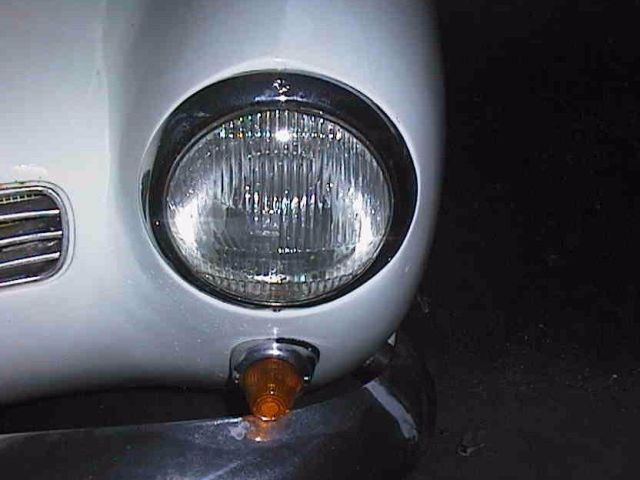

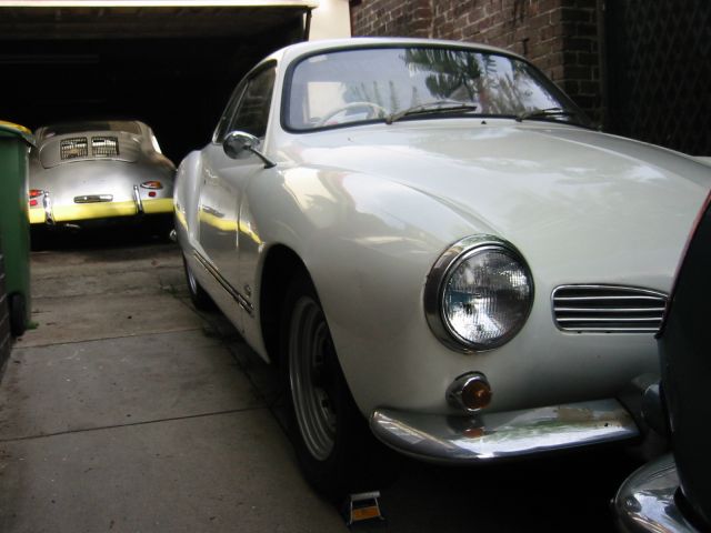

If your not too fussed about originallity, or you want to save those expensive to replace stock headlights, you can fit mini headlights with 7" sealed beams. You can buy them brand new from mini suppliers very cheap and they fit remarkably well.
Standard Headlights
http://www.matara.net/albums/ghia/9_G.jpg
Mini Sealed beam headlights:-
http://www.matara.net/albums/ghia/IMG_2355.jpg
