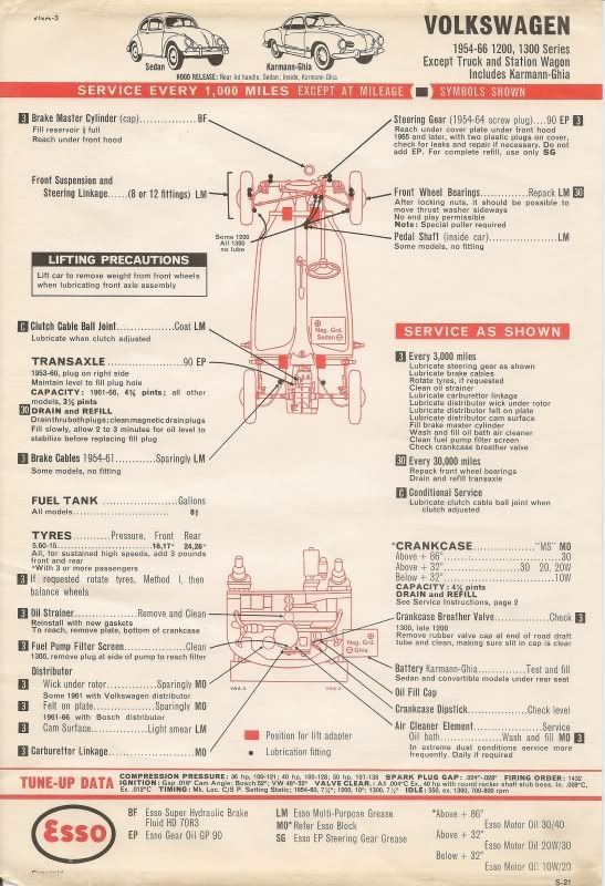

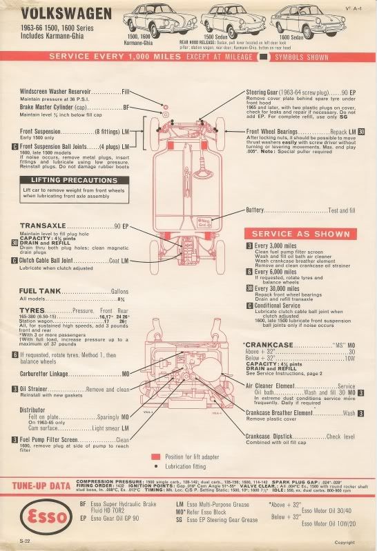

A guy I work with gave me these today. He said he randomly stumbled across them. They appear to be old servicing guides? I'm not too sure but they look old and kinda of interesting. I figured I'd post them up.
http://img.photobucket.com/albums/v260/russel_coight/scan0002.jpg
http://img.photobucket.com/albums/v260/russel_coight/scan0003.jpg

VW DEINST - SERVICE ---
YES
ALL THOSE THINGS WERE DONE TO A BEETLE AT A SERVICE..
OIL DOOR HINGES...
OIL PEDALS... ETC...
