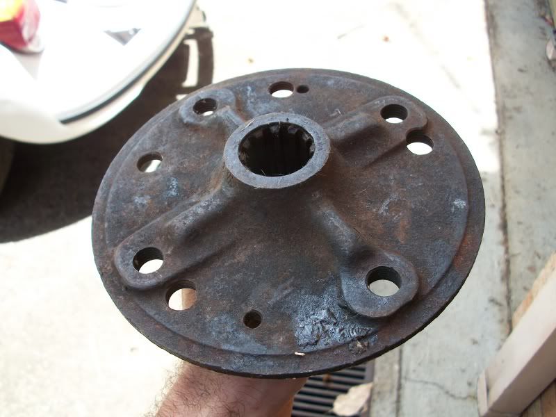

posted on November 27th, 2010 at 11:49 AM
Originally posted by vw54
I wouldnt drill the origional Type 3 hubs as theres not enough meat in between the origional holes to have new holes drill as per above you would only get 3 or so threads for a studs
I just had a better look at mine, Its actually just the original hole thats through the rib, all 4 new ones arent
well technically 3.5 seeing as one half gets a rib :lol:
http://i128.photobucket.com/albums/p174/Buggin_74/100_3085.jpg

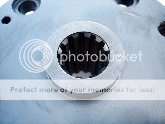

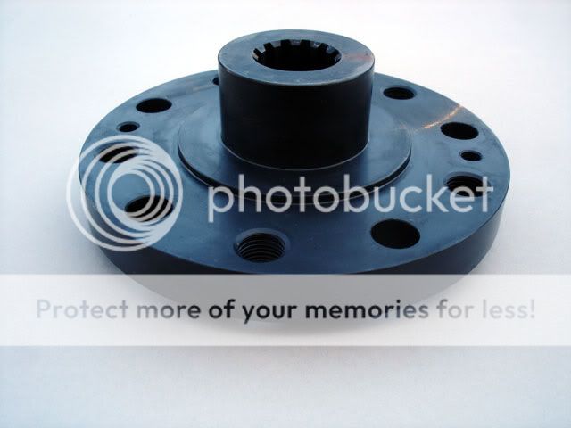

posted on November 27th, 2010 at 12:45 PM
http://i999.photobucket.com/albums/af113/Aussiedubbin/GA-501581P-6.jpg
MemberAussie Dubbin
Posts: 895

posted on November 27th, 2010 at 03:11 PM
bit on the thin side Joel
the ones above look meatie
