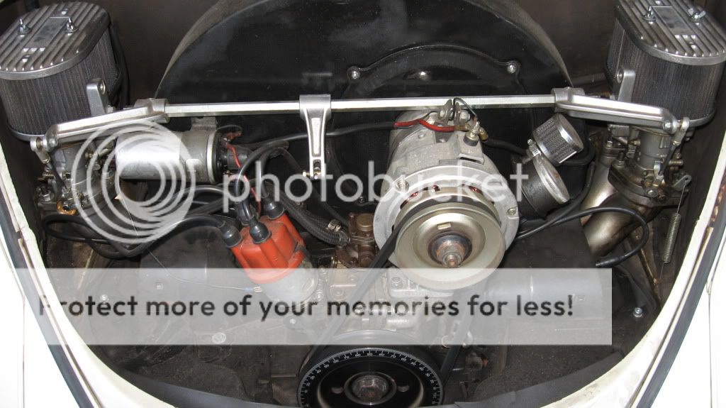

I run a 1600 with a counterweighted crank, w110 cam, 1.25 ratio rockers, dual 40idf's, A1 sidewinder, 044's with 40x35.5 valves and static compression at 8.6:1, lightened flywheel and kennedy stg 1 pressure plate. It's completely different to a stock 1600. I built mine from the ground up which is what I recommend you do, if I had the opportunity to do it over I would have gone for a 74mm stroke and probably 90.5 pistons and cylinders with the same heads cam etc, but as a first time performance engine build up I've been really happy with the result. I drive it on a daily basis, and have driven it across Aust a couple of times and also up through the centre averaging 120kph. It has only let me down once in the 10yrs since I built it, a faulty distributor button:no:
Extra HP? I don't know but it has great torque from 1800 rpm to 4000 and more than enough to keep up on the freeways.
Sounds like a great set up.
You would happen to have any pictures of that now would you?

Member66brm
Posts: 140
Threads: 4
Registered: November 13th, 2009
posted on January 18th, 2011 at 09:11 PM
http://i977.photobucket.com/albums/ae251/andrew_howman/037.jpg
