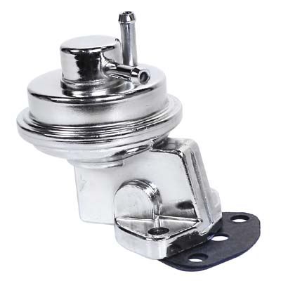

if its a beetle pump, just buy a sealed one with out the holes in the side , I never had a problem.
http://img.photobucket.com/albums/v419/montem/129240.jpg

posted on January 31st, 2011 at 10:07 PM
Ian were did you buy that one from?
59 Microbus Kombi (MERCY)
64 Microbus Kombi (CHANNON)
Memberian.mezz
Posts: 3913
Threads: 280
posted on February 1st, 2011 at 07:15 AM
I think it come from classic veedub, about $40
its one of those dressy chrome ones
