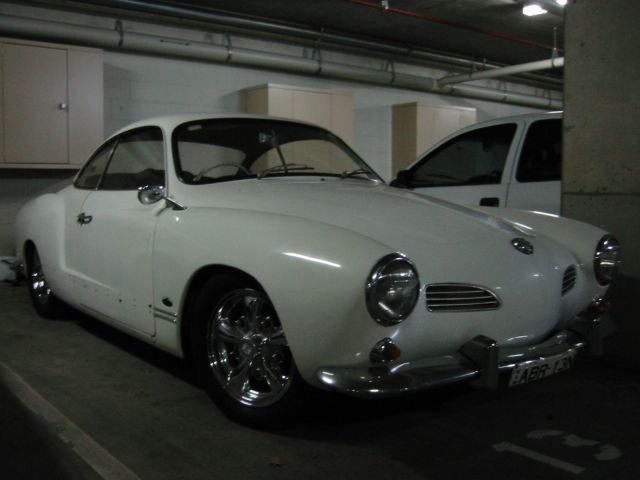

I managed to get 15" Empi 5's on with beam adjusters only. No rubbing!
http://www.matara.net/albums/ghia/IMG_0545_001.jpg

That looks nice what size tyres have you got on it?
Also I see you are missing the chrome strips on the doors I have a new set I'm not using Pm me if interested
Membermatara
Posts: 1342
Threads: 255
Mood: 356'd
posted on June 26th, 2011 at 09:41 PM
Thanks but the car has long since gone. From memory it had 185/65/15 tyres on the front and 205/70/15 on the rear. The rears were tight but didn't rub. Cars now in Geelong and has been restored.
