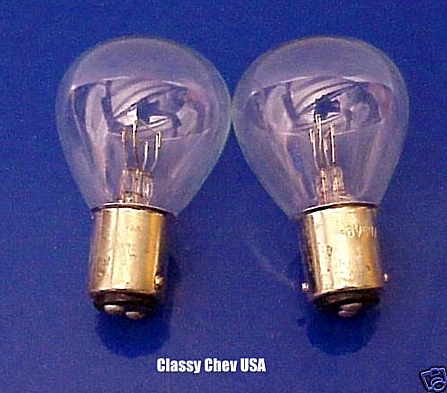

The original asymmetrical bulbs you have look abit like this?
http://www.classychevusa.com/cartimages/prd_796.JPG

Yeah Joel that's them, just come back from the Hella supplier here in Newie but not much luck, they are going to get in touch withGHQ Monday, here's hoping

Well I read here about companies not answering emails, here's one that does. I emailed clasic and vintage bulbs this morning, I have now had two replies as under, good service from an Ausie company. :tu:
Hi Don
I have both types as halogen in 6v or 12v The original type posted by Joel are the ba20d versions and the other in the pic from Classy Chev are the ba15d type
Hi Don Me aagin
Let you mates know that I have all types of VW headlight bulbs in both normal and halogen 6v and 12v. P45t, P43t, Ba20d as well as all the other 6v bulbs VW use.
Anthony Pearson
I'll send off an email to get costs etc, looking good, of course if I go this way I'll have to get some spares, even though the ones in the headlights at the moment have been there for a bloody long time.
