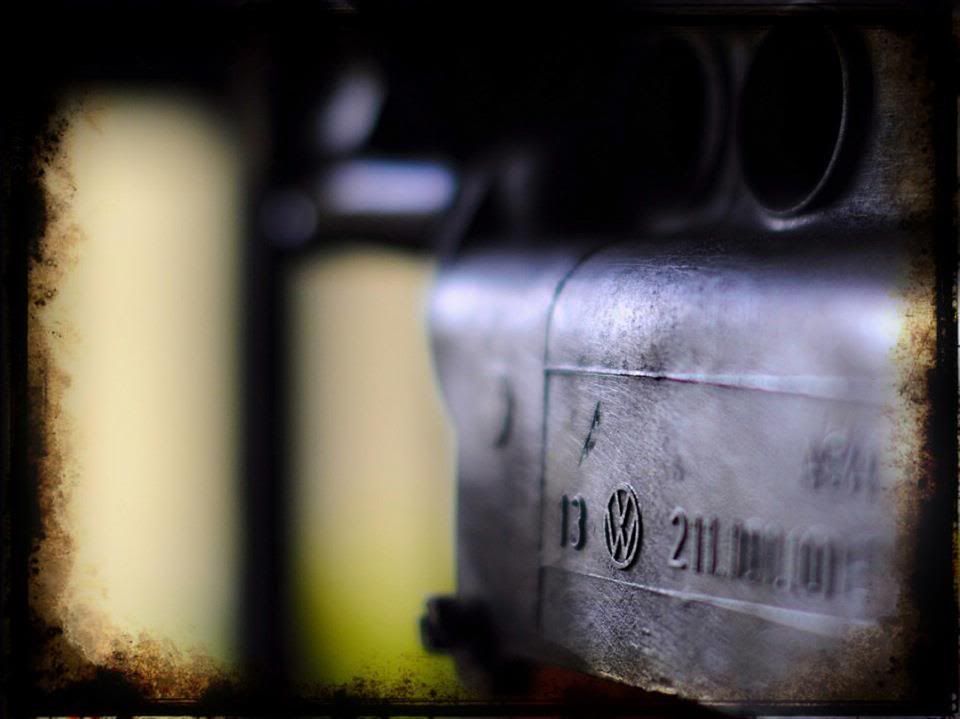

well i went and bought a squareback whoop whoop here is some pics of work so far not found much rust so all the usual rot spots look pretty good although never had a type 3 before (had busses and bugs in the past)[img]http://i1113.photobucket.com/albums/k519/dave1342/267654_10150377162874782_837084781_10374339_3442021_n.jpg

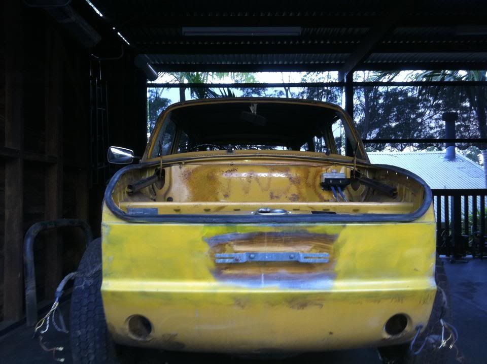

Slow progress but here's some more pics
[img]http://i1113.photobucket.com/albums/k519/dave1342/vw%20type%203/380162_10150515441654782_837084781_11478263_989950708_n.jpg http://i1113.photobucket.com/albums/k519/dave1342/vw%20type%203/320709_10150515442579782_837084781_11478273_2124359142_n.jpg http://i1113.photobucket.com/albums/k519/dave1342/vw%20type%203/376207_10150515441344782_837084781_11478260_358837399_n.jpg http://i1113.photobucket.com/albums/k519/dave1342/vw%20type%203/296041_10150515442234782_837084781_11478269_961761571_n.jpg http://i1113.photobucket.com/albums/k519/dave1342/vw%20type%203/304278_10150515441929782_837084781_11478267_1466367765_n.jpg[/img]

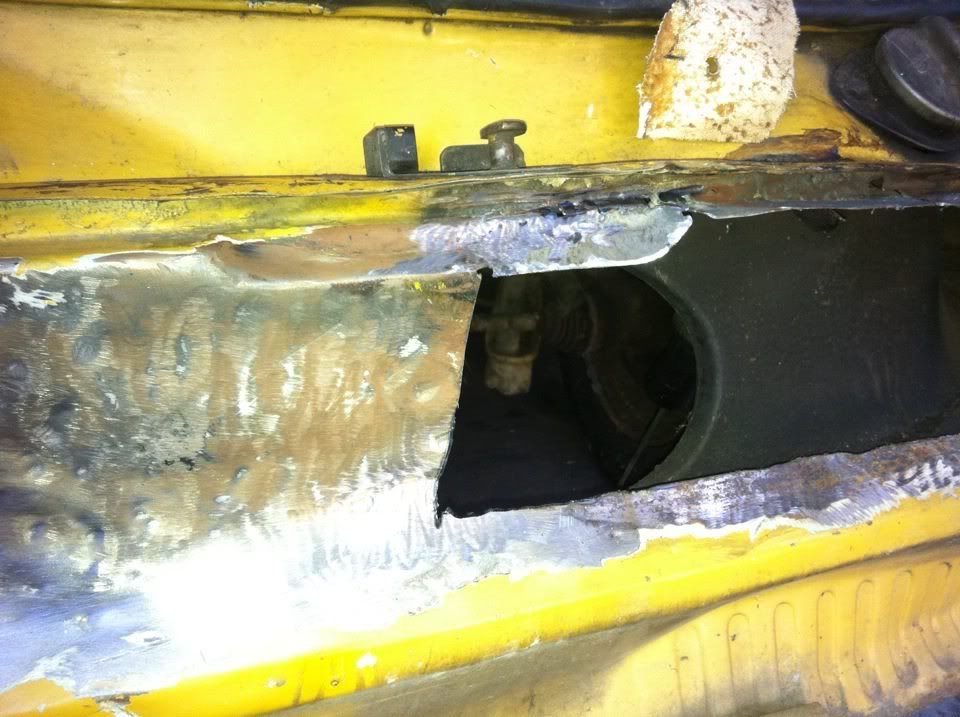

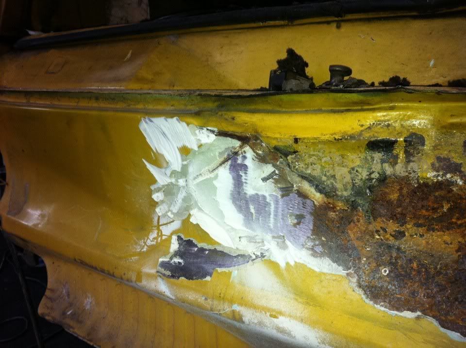

Can anyone tell me if this is normal it seems to have been sealed with fibre glass or something I thought it as gonna be hiding something sinister but when I scraped some off just metal,
[img]http://i1113.photobucket.com/albums/k519/dave1342/380471_10150515442944782_837084781_11478277_1256152538_n.jpg[/img]

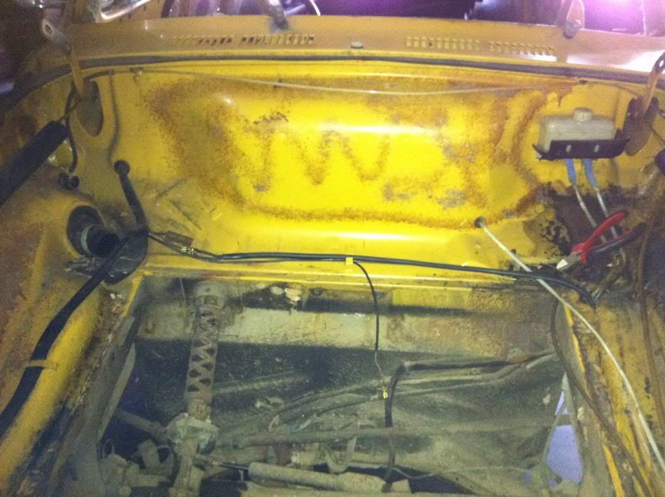

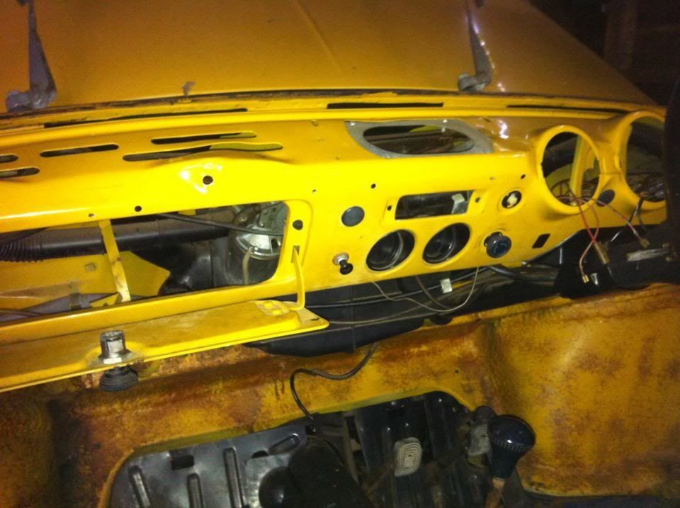

and some more.
[img]http://i1113.photobucket.com/albums/k519/dave1342/Type3/386248_10150515443474782_837084781_11478282_1057980770_n.jpg
http://i1113.photobucket.com/albums/k519/dave1342/Type3/392079_10150515443249782_837084781_11478281_1419798323_n.jpg

Don't forget to remove the fresh air box, you can feel up and inside for rust. More than likely it's there.
If it is, it's not hard to cut an inspection hole in from the boot. In the 'bulge' at the back of the boot, just below the fresh air inlet you will see a line of spot welds ~2/3rds of the way up. Stay above that line. If you start high and work your way down, there is a seam of rubber/body filler there and best to stay away from that if you can to ease repairing. Or eve nbetter make a removable panel you can check in there once in a while.
I love '73's, best of the lot :)

fresh air box is out and no rust at all will post a pic when i get around to it

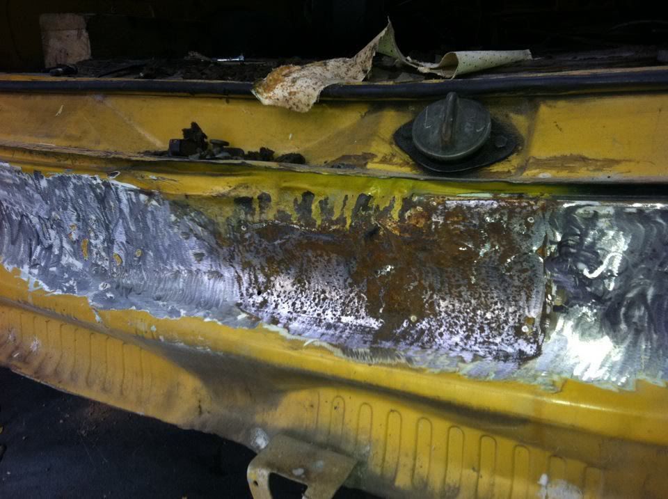

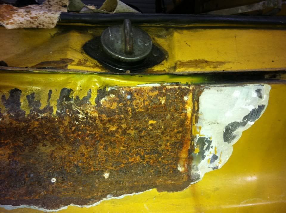

Fresh air vent
[img]http://i1113.photobucket.com/albums/k519/dave1342/da47fb6f.jpg[/img]

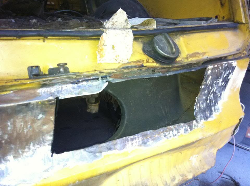

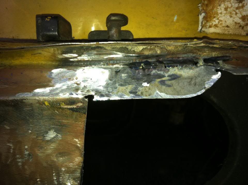

Think my welding needs a bit more practice
http://i1113.photobucket.com/albums/k519/dave1342/94a2747a.jpg

Great to see another type 3 getting ready for the road!!
If you can;t feel any rust inside the fresh air vent, amke sure you fill it will a rust preventer to it stay's that way.

Started to strip some of the flaking underseal stuff and....
http://i1113.photobucket.com/albums/k519/dave1342/c06ad626.jpg
http://i1113.photobucket.com/albums/k519/dave1342/ac2eeb08.jpg
And some more
http://i1113.photobucket.com/albums/k519/dave1342/85474dc8.jpg
And a bit more
http://i1113.photobucket.com/albums/k519/dave1342/c6e4afac.jpg
http://i1113.photobucket.com/albums/k519/dave1342/55923094.jpg
http://i1113.photobucket.com/albums/k519/dave1342/438ce493.jpg
And some primer
http://i1113.photobucket.com/albums/k519/dave1342/d13a50b5.jpg
http://i1113.photobucket.com/albums/k519/dave1342/8ab1f25c.jpg
http://i1113.photobucket.com/albums/k519/dave1342/25f211d8.jpg
