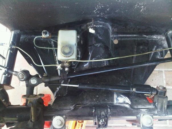

THis is the workaround on aftermarket dual circuit master cylinder by tapping in the second switch on rear line
http://i1140.photobucket.com/albums/n570/tg007tim/384496_10151052034020599_731625598_22266533_1114676626_n.jpg
question.gif posted on December 21st, 2011 at 02:22 PM
I have seen beetles with the two switches but only one switch connected... lol
and My Master cylinder has a stainless steel sleeve in it...
Lee
PS: why was the dual brake switch master cylinder wanted???
back in the 60's I had a dash lamp connected to the brakes so I knew when the brake lights were on... ??
Why?? I have no idea.
Lee
