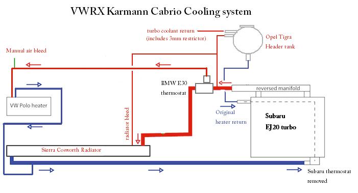

Have to disagree Matt, the shroud is only really for stationary use, it makes sure the airflow is pulled from the radiator and not lost around it. Once you are moving, the shroud has no use at all and is detrimental to flow, that's why some have rubber flaps that blow open when moving..
The OP's problem is the thermostat, you need to ensure that it gets exposed to the engine coolant temperature, in our swaps, this gets too diluted with cold return coolant and this artificially lowers the thermostat temperature which is why the engine temperature rises. This obviously gets worse with a more efficient radiator!
My fix for this is to move the thermostat to the outlet and remove the original, it takes ZERO effort to bleed and gives an extremely stable temperature with fast warm up. An alternative fix is to space off the radiator return flow from the bypass flow using one of the spacers used by the Canadian vanagon guys.
Fitting a small bore bleed at the top of the radiator to the coolant reservoir will ensure you don't get any trapped air in the system.
Thsi is my system:
http://www.ricola.co.uk/images/cabrio/wrx_bug_cooling_system.jpg
