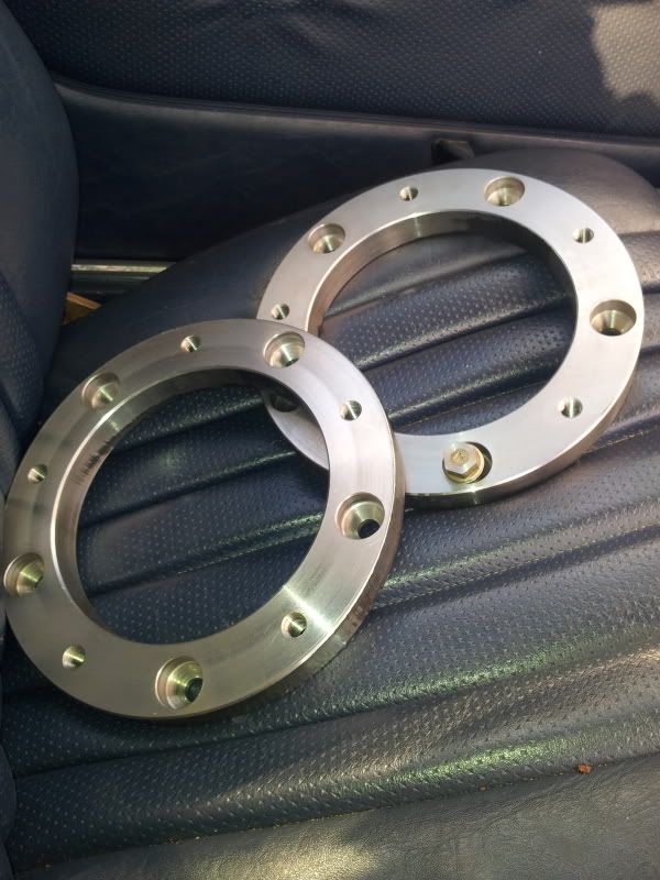

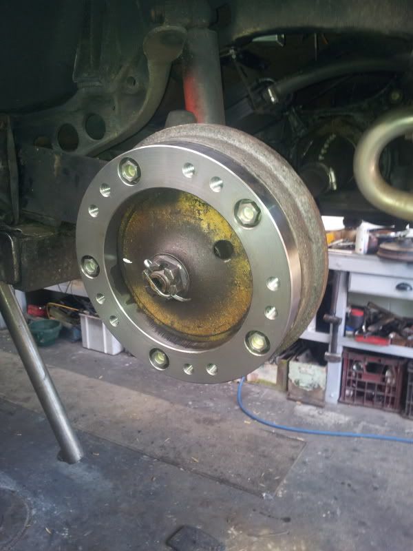

Make sure you do something with threads drilled into the spacer when going 1inch.. having a wheel bolt or stud going 65mm or so will shear if unlucky...
I had these made up.. can get you a quote if you can't find something online.

they look really nice, thats what im after...

Yep there nice look well made too

Those ones i have which machined up, drilled, tapped - come in around $100 for the 25mm flange and around $120/hr to machine up.. close to 250 a pair.
Hurts a little but you know the job is done correct and you wont fail. I wouldn't go near those cip1 25mm spacers.. there is no surface area and the studs have to reach 65mm.. way too much length to be safe.
if you need help making these up drop me a PM. can get them done for you.
