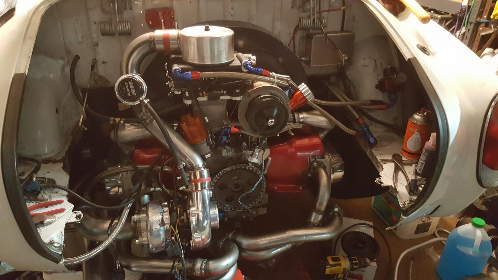

posted on April 30th, 2017 at 12:47 PM
Update time ---- Some dude came up to me an made me an offer I probably should of refused, but I didn't and I gave him the big engine out of the Ghia..... So I'm thinking it is time for a more of a street loving engine for the car -- So here is the new incarnation -- A 2332 with a bunch of goodies.... Probably not the total top shelf build I should of done but has enough good parts to get it running and sorted out.....
Still fabbing stuff together and trying to get everything to play together nicely......... The engine is 1/2 inch wider and 3/8" longer than a stocker, so everything that I bought trying to save time, had to be modified and took more time than piecing everything together.... Here's where I'm as of this morning and I'm planning a full day of attacking this thing, but I'll probably spend most of it chasing parts/bolts/stuff if you know what I mean....
The purple lines on the blow-thru hat on the EFI is where I'm having interference with the deck lid -- I'm trying to decide whether to cut the hat and reweld it at the purple lines or offset the deck lid higher -- kind of leaning towards opening the deck lid up as it will add a little more air flow to the engine also....
http://i586.photobucket.com/albums/ss306/Fiatdude/Ghia/20170427_064535_zpsnofr8syl.jpg

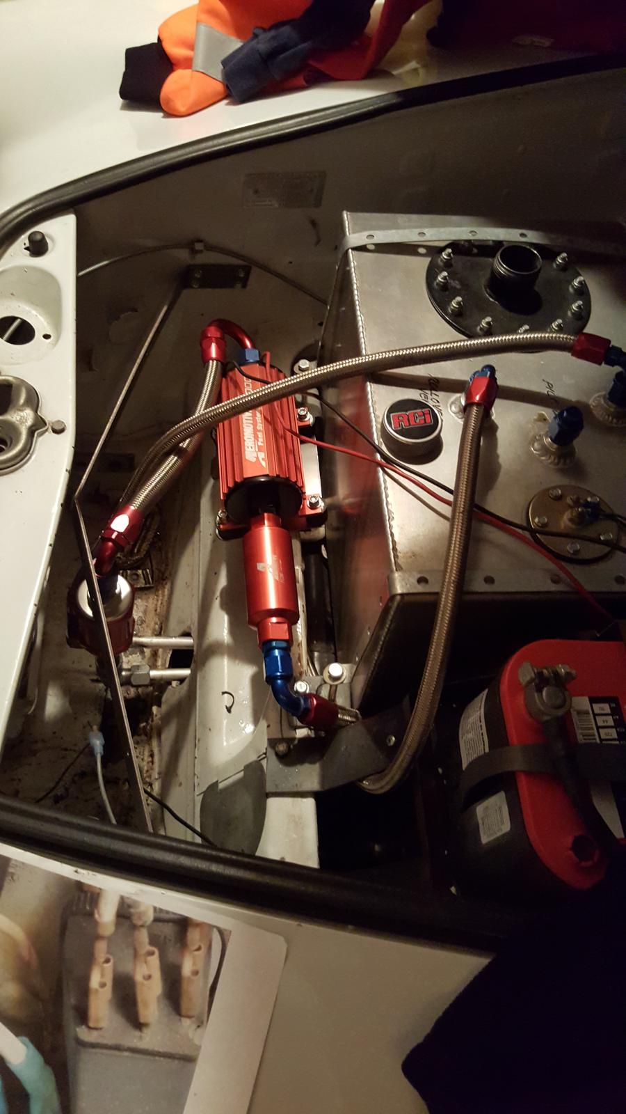

posted on May 13th, 2017 at 02:17 PM
Fuel system completely redone -- just missing two -8an to -6an fittings -- ordered them from Jeg's today........ Redid the front mounting of the fuel pump and ran the 5/8" lines down through the tunnel -- need to take a picture of that
Oil system is next .....
https://www.thesamba.com/vw/gallery/pix/1642301.jpg

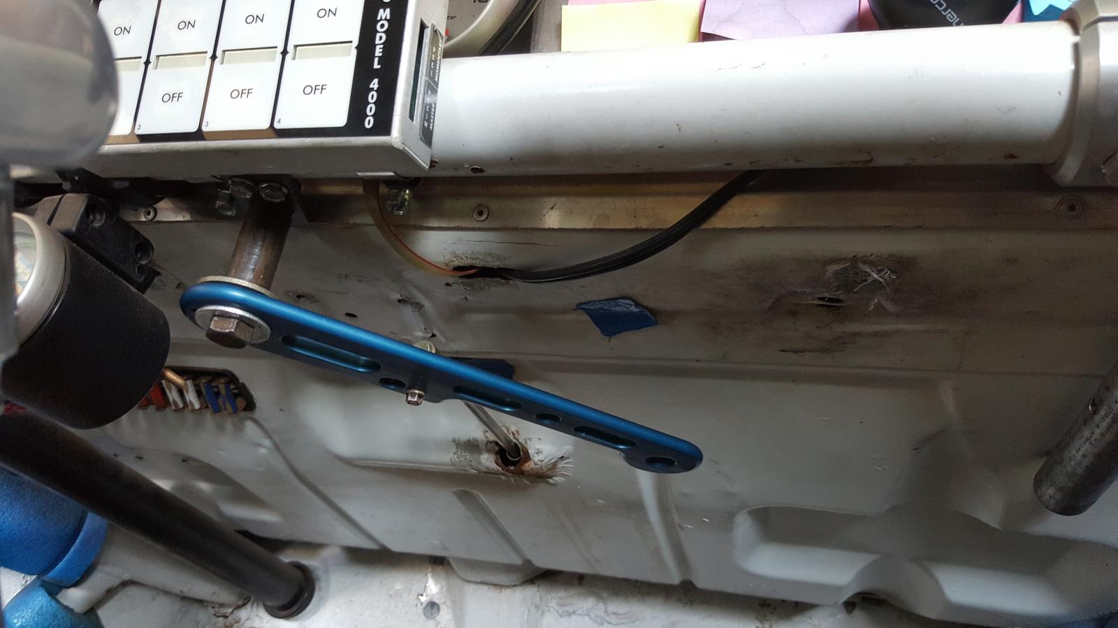

Lance Gregory donated a parachute lever and cable to me after he finished his promod build a few years ago..... I've been having issues with the cable and release for the hood on the Ghia.... Then I got this wild hair and now I've got a bullet proof hood release......
https://www.thesamba.com/vw/gallery/pix/1683974.jpg

Welllllll, Six months later and 3 house rehab projects later....
New parts have arrived, case has been machined, long barrels machined, new cam, new pistons and some total seal rings..... Now I'm looking for all that ambition (OK any ambition) to get started working on this old thing.....
New Parts
https://i.imgur.com/5BVPA1G.jpg
I'm trying to see some new swing arms setting here.... Might have to break out some more ambition. LOL
https://i.imgur.com/ddAdfOf.jpg
