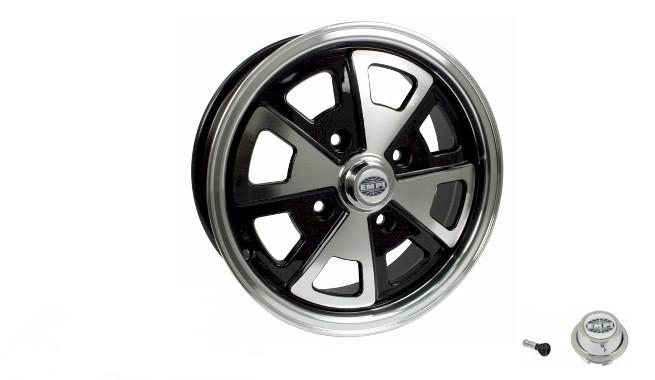

HELP PLEASE - Will these wheels Fit My Superbug?
It's Hard to find a good looking wheel and tyre combo for superbugs unless you go slimline struts but im trying to get a buget wheel and tyre package.
My bug is 80mm lowered in the front and thats why i am wondering will these wheels fit?? they basically same dimentions as stock? but 1" wider overall? im wanting to know will they fit a lowered superbug with say stock tyres on the front? or a lower profile 185/15 ??
Please help me out with any info guys.

You really need to know the ET of your current wheels so you can compare that to any potential wheels that you like, with that information you can determine if the wheel will fit, a 1" increase in width should fit if it has only added a 1/2" increase to the ET.

Okay Cheers Mate,
Im Hoping Joel will stumble across this thread and let me know what the stock ET is on late 70's stock 4 stud bug wheels. :)

I Just Read That The Stock Wheel ET is 25 so im guessing 30 ET with an extra 1" wider would fit?

its fair to say that the width and offset of these wheels are pretty well spot on for the super bug and standard beetle. Note that 15 x 5 1/2 inch with 30 ET (give or take) is about all that you can get these days.
I run 5 1/2 inch with 30 ET on an L Bug and a 1976 standard bug. Although on the L bug you need to consider using thinner strut springs, such as supplied by V Force. Personally I think the Gas Burner or V Force Spider look better than the ones shown above.

I Have an S bug so do you think it would rub on the springs? i know 15x6" do but do 5.5" do aswell?

1010tires or something, offset calculator, it's accurate, compare stock to those & check clearances, and if necessary, find a guard roller, I recall minimal outer clearance because you went so low...

They will fit, tyre choice will be important (get 135 F and 165 R)
posted on August 26th, 2012 at 10:18 AM
They fit well with a narrowish tyre like 165 or smaller
Brad runs them on his 72 and it's lowered on adjustable struts.

Okay No worries, i got 165's for the front, can you get lower profile 165's?
Whats the fattest you could tuck under the back you reccon?
From Dylan
posted on August 26th, 2012 at 10:45 AM
You can get 165/45s but they are like fanbelts
http://a3.ec-images.myspacecdn.com/images01/103/c7dfd46eb0d94ca87a5b45946ce25f7b/l.jpg
depends how much of a staggered look you want but try and keep close to stock rolling diameter in the back, something like a 195/65 or 205/60 to keep revs happy and not rub too much.
