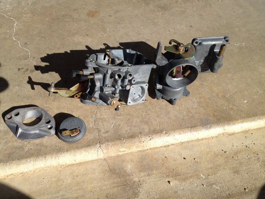

I had a bit of time spare today and thought I'd have a crack at one of the DIY Soda Blasters that are on YouTube ....
http://youtu.be/aQrU06w7LHY
Total cost less than $20 + about half a $3.00 box of baking soda and this carb .....
http://i1251.photobucket.com/albums/hh560/Torxkiwi/370496D5-9952-4158-9C02-45348194187E-2005-000001E05AC0536F.jpg
ended up looking like this ......
http://i1251.photobucket.com/albums/hh560/Torxkiwi/E73E94CE-8564-4003-BE3C-6AB72E4E372D-2005-000001E04088D682.jpg
Just need to run a rebuild kit through it and job done. Took about half an hour, looked a bit like casper the ghost and the back yard had a decent dusting, but all in all far more painless than hours of scrubbing and pissing around.

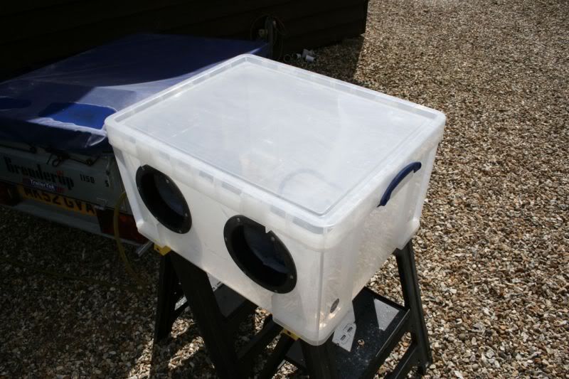

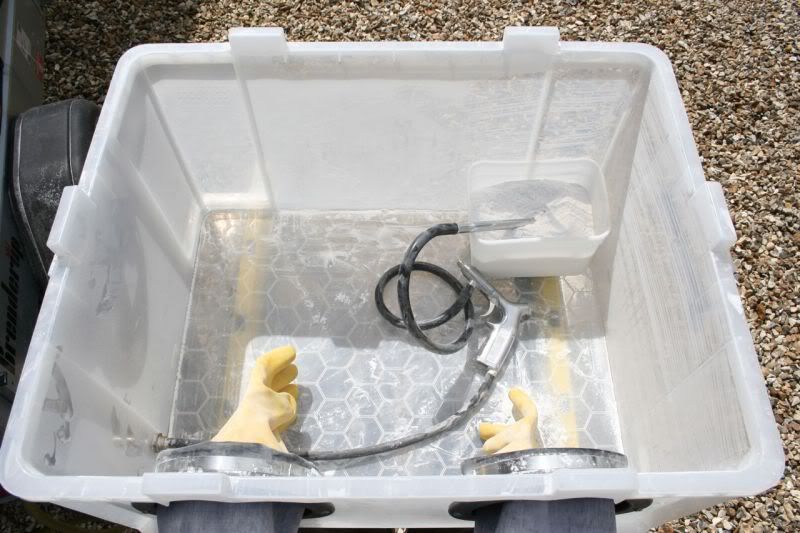

This looks like it would also work quiet well, and from pricing it out, would only cost about 70 - 80 bucks to make.
dose a nice job of keeping the mess in and also recycling the soda, not to mention removing the likly hood of breathing the stuff in while working
http://i908.photobucket.com/albums/ac286/T34FINN/_MG_4945.jpg
http://i908.photobucket.com/albums/ac286/T34FINN/_MG_4939.jpg
