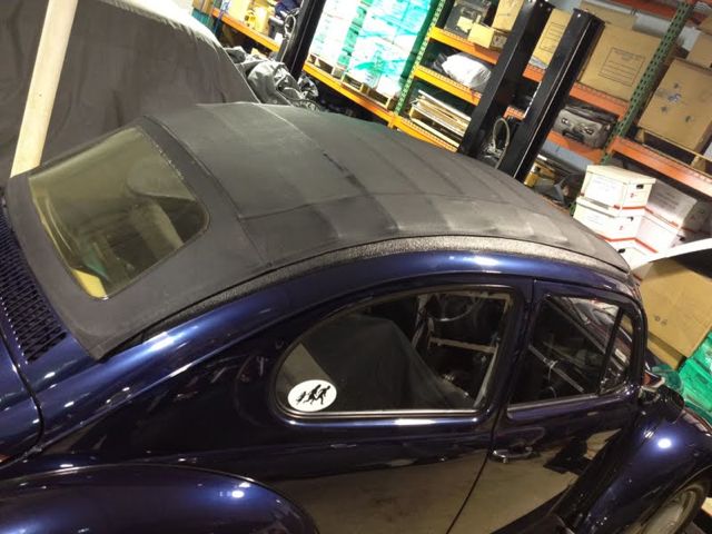

It's just a sardine tin conversion Lee, it's only the sheet metal of the roof thats cut out, the side strengthening is all still there.
A friend owned one by Sunbug in the 90s, they are much sturdier than a full convertable.
Same design as the Mexican factory OpenAir Beetles.
http://www.oldbug.com/zb03.jpg
Although most aus converted ones just have button on tops.

Tin top to rag top conversion does not legally require an engineers report. It is still a sedan vehicle. It is only if you convert a Beetle from being a two door sedan to a 'convertible' or 'roadster' that you need an engineers report. This is what I do for a job every day on cars, V8 conversion, 4 wheel discs, chop, convertible, coupe, stretch limo etc. I deal with engineers reports on motor cars based on the NCOP and VSB14 in VIC in the VASS scheme. Other states are similar.
It is a way to get a fun car happening for a budget price. Cut, chop I am always for it. You do not need an engineers report to do a rag top.

I would be keen to see any photos of whats involved with a sardine top or if there are any kits around.
I bought a convertible and found the channels and other sections totally stuffed with rust I have a sedan body which is good but i really wanted the open top. Perhaps this IS the answer!!
