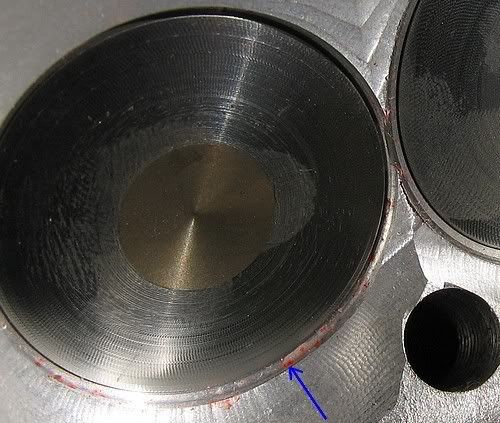

Put a shim under the springs to stop chaffing.
You may like to dowel the manifolds if yours are loose from CB.
Remove sharp edges from the chambers.
http://i113.photobucket.com/albums/n216/dangerous_05/Img_3361.jpg
http://i113.photobucket.com/albums/n216/dangerous_05/Img_3362.jpg
Use a dummy valve to protect the seats from the rotary burr. (Raymond)
http://i113.photobucket.com/albums/n216/dangerous_05/Img_3363.jpg
Perhaps check the valve job is to suit your valve size.
Some are 44 valve and have a seat to suit a 42.
